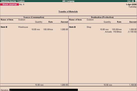

2. Click F7: Stk Jrnl . For example, the company transfers Item B from the warehouse to the shop.

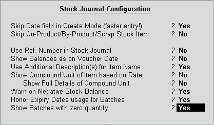

4. Ref: Enter the reference number, if any, or leave it blank.
Note: To get the reference column in the Stock Journal, in F12: Configuration screen set Yes to Use Ref. Number in Stock Journal .
5. Under Source (Consumption) :
● Select the Name of Item from the List of Items , which needs to be transferred under Source .
● Select the Godown from the List of Godowns , from which goods are getting transferred.
Note: The Godown address can be printed in a stock journal voucher.
● Enter the quantity of the items that is getting transferred, along with the rate per unit. The amount will appear automatically.
Note: The rate that is captured here is obtained from the Godown summary.
6. Under Destination (Production) :
● Select the Name of Item from the List of Items under the column Destination .
● Select the Godown from the List of Godowns , to which goods are being transferred.
● Enter the quantity of the items that is being transferred. The rate and amount will be displayed automatically.
Note: You can have a different Rate for Source (Consumption) and for Destination (Production) column for the same Stock Item.
