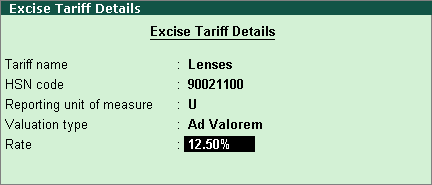

1. Go to Gateway of Tally > F11: Features > F3: Statutory and Taxation .
2. Set the option Enable Excise to Yes .
3. Set the option Set/alter excise tariff details to Yes . The Excise Registration Details screen appears as shown below:
4. Enable the option Set/alter excise tariff details in the Excise Registration Details screen to display the Excise Tariff Details screen.
5. Provide Excise Tariff Details .
● Enter the Tariff name and HSN code .
● Select the Reporting unit of measure and Valuation type .
● Enter the Rate , for example, 12.50% .
6. Press Enter to accept the Excise Tariff Details screen.
7. Accept the Excise Registration Details screen.
