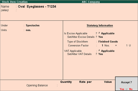

1. Go to Gateway of Tally > Inventory Info. > Stock Items. > Create .
2. Enter the Name of the stock item.

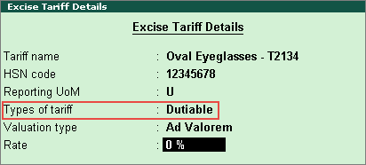

6. Enable the option Set/alter excise details? .
o Enter Tariff Name .
o Enter HSN code .
o Select the Reporting UOM .
o The cursor skips the field Valuation Type . To modify it, click F12: Configure .
o Enter the Rate of duty.
The completed Excise Tariff Details screen appears as shown below:
o Press Enter to save.
7. Enter the Conversion Factor .
o To convert the unit of measure defined in the Units field to the Reporting UOM predefined in the selected Excise Classification .
8. Select Applicable in the field VAT Applicable? , if required.
9. Enable the option Set/alter VAT details? , if required.
10. Enter the Opening Balance , if required. The completed stock item creation screen appears as shown below:
11. Press Enter to accept.
