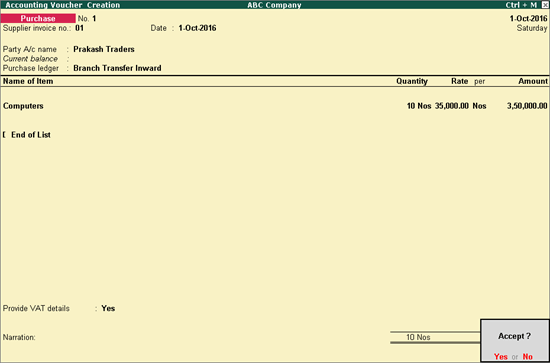

You can create vouchers for the stock received in branch office within the state by selecting the nature of transaction Branch Transfer Inward .

2. Enter the Supplier invoice no. and Date .
4. Select the purchase ledger grouped under Purchase Accounts with the Nature of transaction set to Branch Transfer Inward .
5. Select the stock item. Enter the Quantity and Rate .
6. Set the option Provide VAT details? to Yes . In the Statutory Details screen
● Select the Form to issue , as shown below:
Note: The options in the above screen appear based on the State selected in the Company VAT Details screen.
● Enter the Form serial no. , Form no. and the Date of F Form .
● Press Enter to save and return to the purchase invoice.
7. Press Enter to save.
