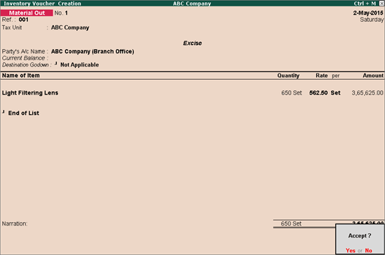

Stock Transfer Outward - Material Out Invoice
1. Go to Gateway of Tally > Inventory Vouchers > Press Ctrl+J . On enabling excise, the material out invoice will be considered for Excise .
2. Enter the reference number in Ref field.
3. Select the required Tax Unit .
4. Select the branch ledger grouped under Branch/Divisions in Party’s A/c Name option.
5. Set the Destination Godown to Not Applicable .

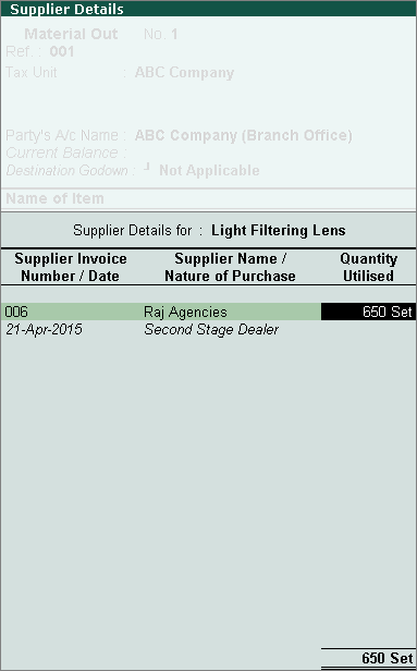

6. Select the stock item to view the Supplier Details screen and provide the required details.
7. Select the Godown , enter the Quantity and Rate to display the amount in the Stock Item Allocation screen.
8. Accept the Material Out invoice.

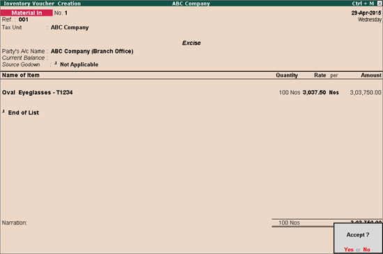

Stock Transfer Inward - Material In Invoice
1. Go to Gateway of Tally > Inventory Vouchers > Press Ctrl+W . On enabling excise for dealer feature, the Material In invoice will be considered for Excise .
2. Select the required Tax Unit .
3. Select the branch ledger grouped under Branch/Divisions in Party’s A/c Name option.
4. Select the Nature of Purchase i n the Party Details screen.
5. Set the option Source Godown to Not Applicable .
6. S elect the required stock item .
7. Select the Godown , enter the Quantity and Rate in the Stock Item Allocation screen.

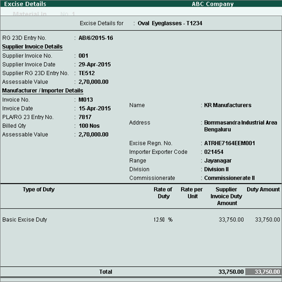

8. Provide the required details in Excise Details screen.
9. Accept the Material In invoice.
