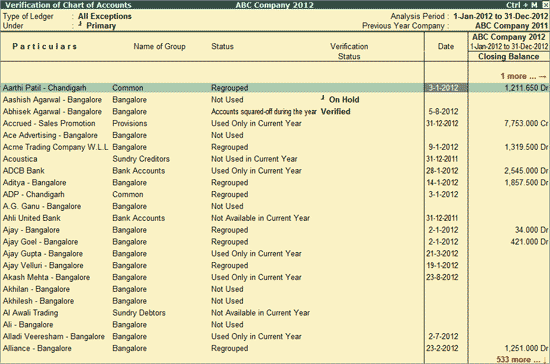

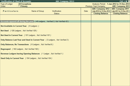

The Verification of Chart of Accounts report classifies and displays all the exceptional ledgers (All Exceptions) along with the ledger count and verification count with the following status:
● Accounts squared-off during the year : Ledgers having transactions with accounts squared-off (nullified/adjusted) will be displayed under this status.
● Not Available in Current Year : Ledgers that have been discontinued (not present) in the current year will be listed under this status.
● Not Used : Ledgers which do not have any balance and have not been used in recording any transaction during both the years will be displayed under this status.
● Not Used in Current Year : Ledgers which have been used for recording transactions only in the previous year, have no Closing Balance (from the previous year), and have no Opening Balance in the current year will be listed under this status.
● Only Balance Last Year and Used in Current Year : Ledgers that have only balances in the previous year but have been used for recording transactions during the current year will be displayed under this status.

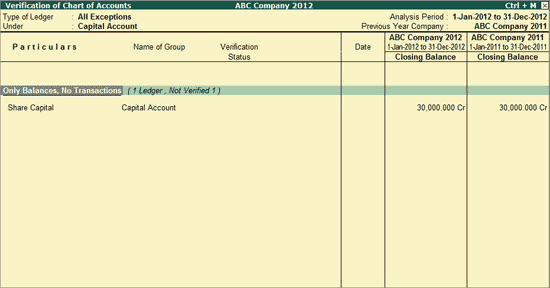

● Only Balances, No Transactions : Ledgers that have only balances, but have not been used for recording transactions during both the years will be displayed under this status.
● Regrouped : Ledgers for which the Primary Groups are different for the two years will be displayed under this status. Sub-group level changes can be seen by using F12: Configure.
● Revenue Ledgers having Opening Balances : Ledgers created under the P&L Group (e.g. Expenses, Income etc.) and having Opening Balance will be listed under this status.
● Used Only in Current Year : Ledgers (with or without Opening Balance) that have been used to record transactions only in the current year will be displayed under this status.

● F1 : Detailed : Click F1 : Detailed or press Alt+F1 to view the list of ledgers under each status explained in the earlier section.
● F4: Group : Click F4 : Group or press F4 to filter for ledgers belonging to a particular group.
o Select the required Group from the above screen and press Enter .

● F5: Led-wise : Click F5 : Led-wise or press F5 to view the ledger-wise Verification of Chart of Accounts report as shown:
Press F5 : Grouped or F5 to toggle to Group-wise report.

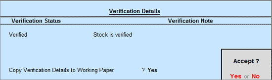

● F9 : Verify : Click F9 : Verify or press F9 to mark any ledger as Verified .
Note: The facility to mark a Ledger as Verified is provided only for those Ledgers which are present in the Analysis Year (List of Accounts).
o In Verification Details screen, under Verification Status field, select the required status - On Hold or Verified .
o Enter the required remarks in the Verification Note .
o By default, the option Copy Verification Details to Working Paper will be set to Yes . Once the Verification Details are saved, the details will be captured in Working Paper .
Note: In the case of Verification of ledgers, there will be only options Verify and Hold in the Verification Status. However, in the case of verification of vouchers, there will be an additional two options: Internal observation and External Clarification
Note: The option Copy Verification Details to Working Paper will be displayed in Verification Details screen only when the  Working Paper is enabled in F11 : Accounting Features .

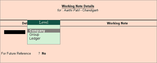

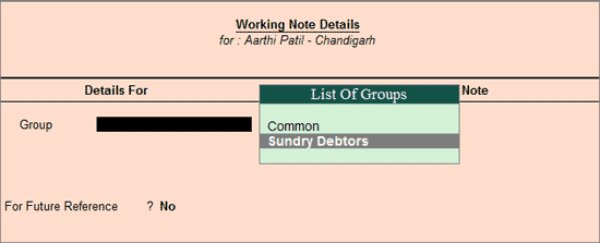

● W: Working Note : Click W : Working Note or press Alt+W to specify the working note details at Company , Group , Ledger , Voucher levels. The details provided in working note will be captured in Working Paper along with the details of User Name, Working Note Date & Time, Status, Note and so on. In Working Note Details screen,
o Details for : In this field, select the level for which the working note is to be entered.
o Company : On selecting Company as the level, the cursor will move to Working Note field.
o Group : On selecting Group as the level, a List of Groups (based on the ledger selected) will be displayed for defining the Working Note
o Ledger : On selecting Ledger as the Level, the Ledger selected for creating the Working Note, will appear under Details For by default.
o Working Note : In this field enter the Working Note details.
o For Future Reference? : By default this option will be set to No . Set the option to Yes , to carry the Working Note forward to the next analysis period. That is, the Working Note details will be displayed in  Working Paper of Current as well as Next Analysis Period.

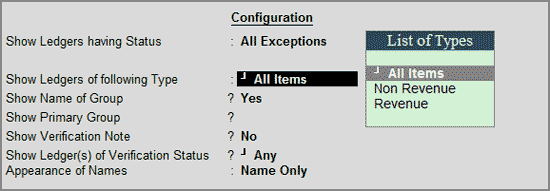

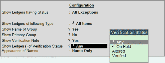

Click F12 : Configure or press F12 to change the configuration for the displayed report.
● Show Ledgers of Having Status : Select the required Types of Exception from the list to display the ledgers belonging to the selected Status.
● Include Subgroup Changes also (Regrouped) : Set this option to Yes to view the subgroup level changes for a ledger from previous year to current year.
Note: The option Include Subgroup Changes also (Regrouped) will be available only while viewing the report for Regrouped status from the Types of Exception.
● Show Ledgers of the following Type : Select to filter the information for revenue ledgers or non revenue ledgers or both for the Types of Exception already selected.
● Show Name of Group : Set this option to Yes to display the name of immediate Group for each ledger.
● Show Primary Group : Set this option to Yes to display the name of the Primary Group for each ledger.
● Show Verification Note : Set this option to Yes to display the verification note entered by the user.
● Show Ledger of Verification Status : Select to filter the information for On Hold ledgers or Verified ledgers or Altered ledgers or Any for the Types of Exception already selected.
● Appearance of Names : Select the required Display Names Styles from Alias (Name), Alias Only, Name (Alias) and Name Only for the Ledger names.

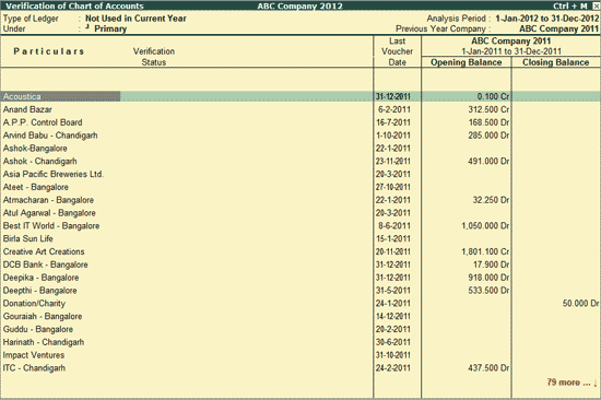

The facility to view the ledgers belonging to a particular status is also provided by pressing Enter on the required status form the Verification of Chart of Accounts report for All Exceptions. The report for ledgers Not Used in Current Year is displayed below:
The buttons available in the above report are similar to the buttons available under Verification of Chart of Accounts report for All Exceptions .
The user can bring the cursor on the ledger and click F8: Show Ledger or press F8 view the Ledger Vouchers report.
Note: The Ledger Vouchers report is available only for the Current Year.
