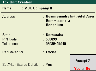

Create a tax unit
1. Go to Gateway of Tally > Accounts Info. > Statutory Info. > Tax Unit > Create .
2. Enter the Name and Address as registered under excise.
3. Select the State , e nter the PIN Code and Telephone number.
4. Enable the option Set/Alter Excise Details .
5. Select the Registration type as Dealer .
6. Enter the ECC No .
7. Enable the option Set/alter excise tariff details and define the tariff details .
8. Accept the Tax Unit Creation screen.

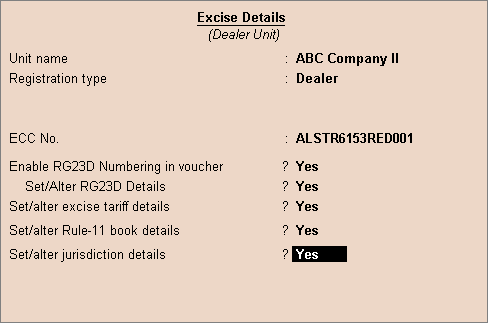

In the Configuration screen of Excise Registration Details of Tax Unit , set the following options to Yes :
● Enable Rule 11 Book details : This can be used to create Rule 11 book and define the numbering format.
● Enable jurisdiction details : This can be used to define the tariff details for the tax unit.
● Enable RG23D numbering : This can be used to define RG 23D numbering format with prefix and suffix.
● Providing Additional Details for Tax Unit
On enabling the configuration options, additional options are displayed in Excise Registration Details screen of Tax Unit .
Provide additional details
1. Enable RG23D Numbering in voucher : Enable this option to use RG23D automated numbering feature while invoicing.
2. Set/Alter RG23D Details : Enable this option to set the format of RG23D numbering with Prefix and Suffix .
3. Set/alter Rule-11 book details : Enable this option to create the excise book and define the numbering format. The book number linked to the tax unit appears automatically in the invoice. If multiple books are created for a tax unit, all the books will be listed for selection while recording the invoice.
4. Set/alter jurisdiction details : Enable this option to provide details of Range, Division and Commissionerate as explained in the topic Enabling Excise for Dealers .
5. Accept the Excise Registration Details screen.
