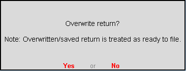

3. Click F6: Overwrite to overwrite the existing return details with modified details.
● The following message appears for VAT return :
● The following message appears for VAT return, which is considered for filing annual return:
4. Click Yes to overwrite the return.

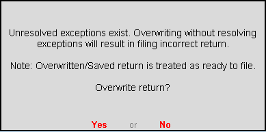

While overwriting the return without solving exceptions, the message appears as shown below:
While overwriting annual return without solving exceptions, the message appears as shown below:
Click No to cancel. Resolve the exceptions in periodic returns, recompute and overwrite again. Click Yes to overwrite with exceptions.
