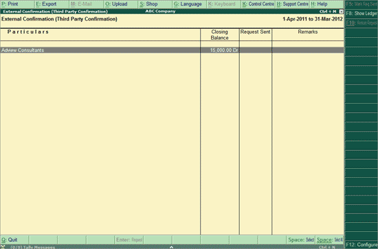

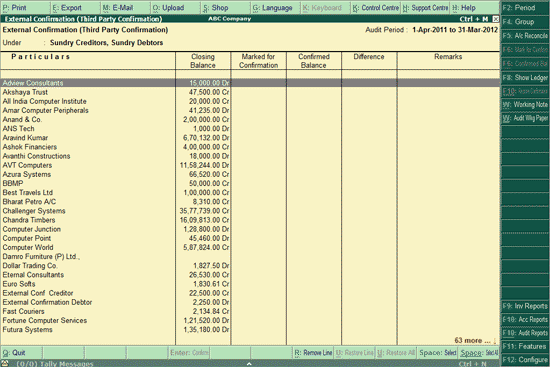

● Go to Gateway of Tally > Audit & Compliance > Audit & Analysis > Other Analysis > External Confirmation (Third Party Confirmation) .
By default, the Ledgers that will be displayed in this report will be those grouped under Sundry Debtors and Sundry Creditors .
● To add another group of Ledgers, like Loans received etc., to be displayed in the report, click F4 : Group , or press F4 .
● Select the required Groups, and press Enter or Y to Accept the selection.
● The ledgers that have been categorized under the selected Groups will be displayed now.
● To mark a Ledger for external confirmation, press Spacebar and click F6 : Mark for Confirm or press F6 .
The Ledgers which have been selected for external confirmation will appear marked Yes in the column Marked for Confirmation, as shown below:

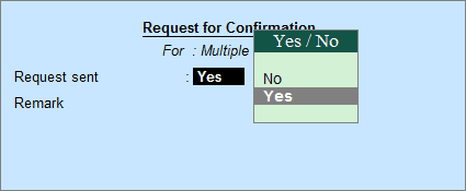

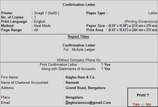

● Marking a single ledger
● Marking Multiple Ledgers

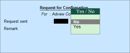

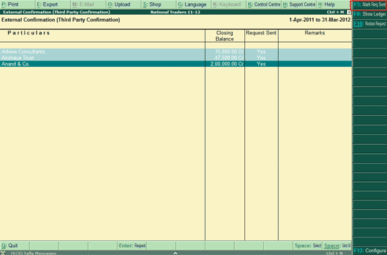

In the External Confirmation (Third Party Confirmation) report at the Auditor’s end, Request Sent (client) will appear in the Particulars column below the names of the Ledgers for which Confirmation request has been sent:

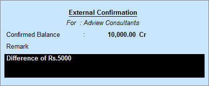

If only a statement of the balance as per the party’s books has been received by the auditor, the same can be entered as confirmed balance in the report.

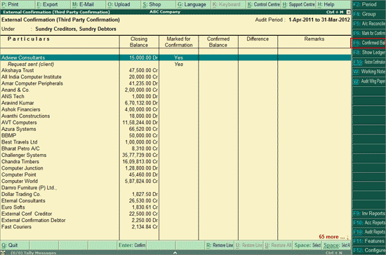

● Place the cursor on the required Ledger and press Enter , or press Spacebar and click on F6 : Confirmed Bal or press Alt+F6 .
The External Confirmation sub-screen is displayed:
● In the Confirmed Balance field, the balance as stated by the party concerned has to be entered.
● Any observations can be entered in the Remark field.
● If the balance as per the client’s books and the balance confirmed by the party do not match, the extent of mismatch will be reflected in the Difference column.

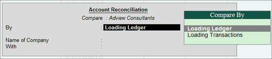

If detailed information has been received from the party concerned, click on F5 : A/c Reconcile or press F5 .
The Account Reconciliation sub-screen is displayed:
● Where the data received from the third parties can be loaded as a company on Tally.ERP 9, reconciliation can be done by Loading Ledger .
● Where only a statement of accounts has been provided by the party, reconciliation can be done by Loading Transactions .

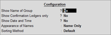

Click F12 : Configure or press F12 to change the default view of the External Confirmation report.
● Show Name of Group : Set this option to Yes to view the Accounting Groups under which the Ledgers have been classified.
● Show Confirmation Ledgers only : Set this option to Yes to view only those Ledgers which have been marked for Confirmation .
● Show Date and Time : Set this option to Yes to view the date on which the request for confirmation was sent by the client along with the time at which it was sent.
● Appearance of Names : Select the Display Name Style as required.
● Sorting Method : Select the required sorting method -Alphabetical, Amount-wise, or Tally.ERP 9's Default sorting method  for the transactions from the list of Sorting Methods.
