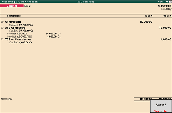

11. Enter Narration , if required. The Journal voucher appears as shown below:
12. Press Enter to save the voucher.
