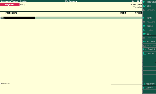

On 30th June you want to view the Balance Sheet as of that date, but June rent is not due for payment until the first week of July. This liability is not reflected in the Balance Sheet. To overcome this, enter an Optional Voucher dated 30th June. The above entry is made as shown:
Click on Optional or Ctrl+L to make the voucher as Optional Voucher
Pass the entry as shown:
● Debit – Rent Account
● Credit – Cash/Bank Account
