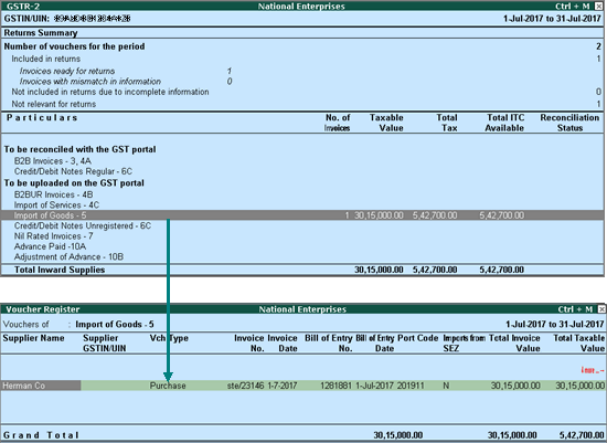

You can view the corresponding impact in GSTR-2 , and drill down Import of Goods Invoices for more details .
Note: Click F12: Configure in the Voucher Register and enable the required options to view the invoice details.

You can view the corresponding impact in GSTR-2 :
To add the column Eligible Integrated Tax Amount to GSTR-2 , open the table Import of Goods Invoices in GSTR-2 , press F12 and enable the option Show Eligible Amount? Now GSTR-2 along with the column for eligible amount will appear as shown below:
