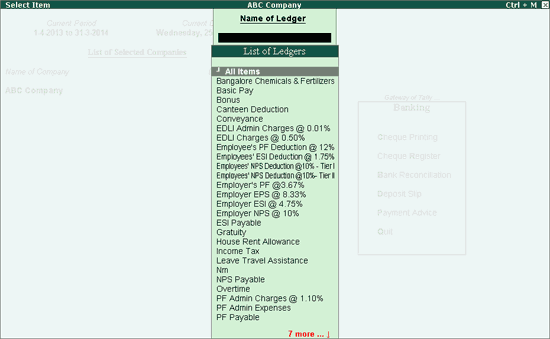

1. Go to Gateway of Tally > Banking > Payment Advice .
2. Select the required l edger and press Enter .
Note: If the option All items is selected, the payment advice for all transactions will be displayed.

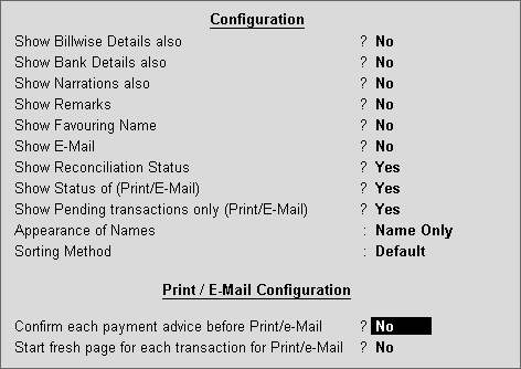

4. Press F12:Configurations for more options. The configuration screen appears as shown below:
o Confirm each payment advice before Print/E-mail: If user selects transactions belonging to different parties  for mailing/printing, the confirmation screen will be displayed one by one for each party's payment advice. If this option is set to No, the confirmation screen will be displayed once.
Note: The option will appear only when the user selects the option All Items from the List of Ledgers.
o Start Fresh page for Print/E-mail : When this option is set to Yes , and if the user selects transactions for mailing/printing, belonging to same party, then print/mail  for a transaction will happen per page at a time (without combining all transactions into one page).

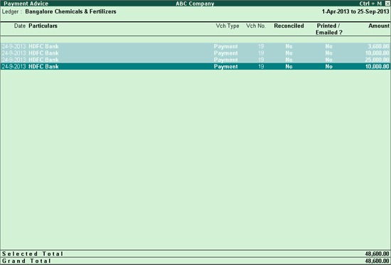

Print the Payment Advice when a single ledger is selected
1. Go to Gateway of Tall y > Banking > Payment Advice .
2. Select the required l edger account from List of Ledgers . The Payment Advice screen, displaying the list of payment vouchers, appears as shown below:

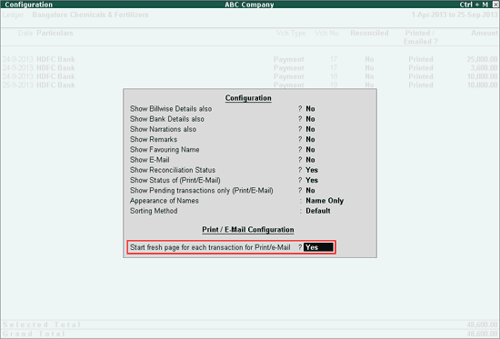

Print each transaction or Payment Advice on a separate page
1. Press F12:Configure.
2. Set the option Start fresh page for each transaction for Print/e-Mail to Yes, as shown below:
3. Accept the screen.

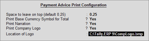

1. Click F12: Configure button or press F12 key from the Print Report of the Payment Advice screen. The Payment Advice Print Configuration screen appears as shown below:
Note: The Payment Advice Printing Configuration screen allows the user to enable/disable Printing Company Logo . T he Location of Logo set in F11: Accounting Features will be the pre-filled in this screen, and can be altered as per requirement.
2. Set the required options and press Ctrl+A to save the settings. The Print Report screen will appear.

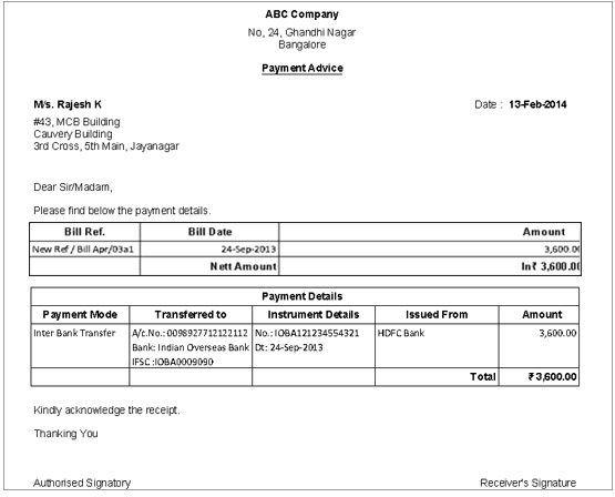

3. Press Ctrl+A or click Accept to print. The print previews of the selected payment advice will appear as shown below:
