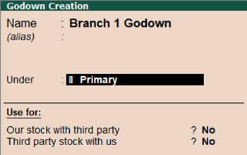

Create Godowns/Locations
To start allocating your stock items in godowns, you need to create a godown first.
1. Press F11 (Features) > Inventory Features > and set Maintain multiple Godowns as Yes .
2. Gateway of Tally > Inventory Info. > Godown > Single Godown > Create .
When you create a Godown/Location in Tally.ERP 9 for the first time, you are prompted to alter the existing internal godown ( Main Location ), where all your inventory is stored by default.
3. Name & alias : As in other masters, you can specify multiple aliases for the godown name.
4. Under : Select Primary or Main Location.
What you see on the screen can vary based on your choices. Press F12 (Configure) to change the options.
Note: As in the case of other ledgers and groups, Primary is the root under which you can create a godown. By default, Main Location is available under Primary. When you create a godown, selecting Primary creates the godown at the same level as that of Main Location. If you select Main Location, it becomes the parent godown for the new godown.
Click to see the F12 configurations for godowns .
5. Accept the screen. As always, you can press Ctrl + A to save.
You can create godowns on the fly or move back and forth when creating godowns. See more...

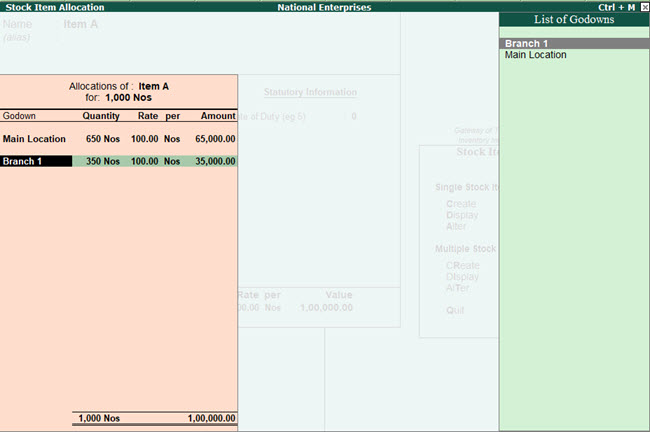

Allocate stock items to Godowns/Locations
Once you have created the required godowns, you can allocate your stock items to one or more godowns.
1. Open the Stock Item Allocation screen.
â—Ź To allocate the opening balance of your stock, in the Stock Item Alteration screen, select Opening Balance and press Enter .
â—Ź To allocate stock items during voucher entry, in the Voucher Creation screen, select the stock item and press Enter .
A sample Stock Item Allocation screen is as shown.
What you see on the screen can vary based on your choices. Press F12 (Configure) to change the options and F11 (Features) to enable or disable features.
2. In the Stock Item Allocation screen, provide the Quantity if UoM is defined for the item; otherwise, provide the Amount .
The quantities and amount entered in the allocations screen are consolidated and displayed in the voucher. The Opening Balance Quantity or Value specified in the stock item must be completely allocated among the selected godowns.
