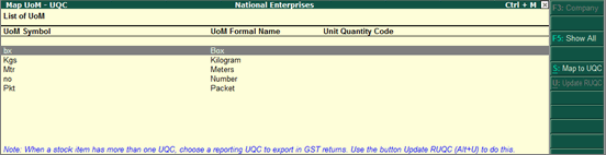

To map UoM to UQC
1. Go to Gateway of Tally > Display > Statutory Reports > GST > Map UoM - UQC .
2. Select the UoM that has to be mapped to its UQC, and click S : Map to UQC .
3. Select the right UQC from the predefined list.
4. Press Enter to map. Similarly, you can map each UoM to the right UQC.
