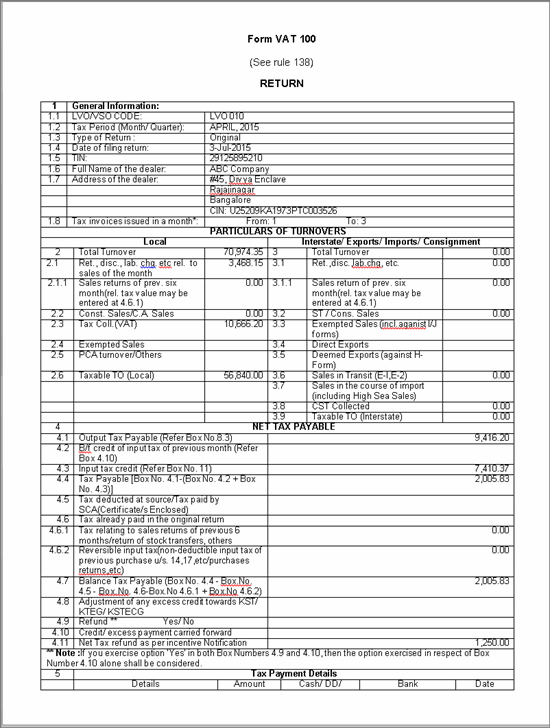

Form VAT 100 - Page 1

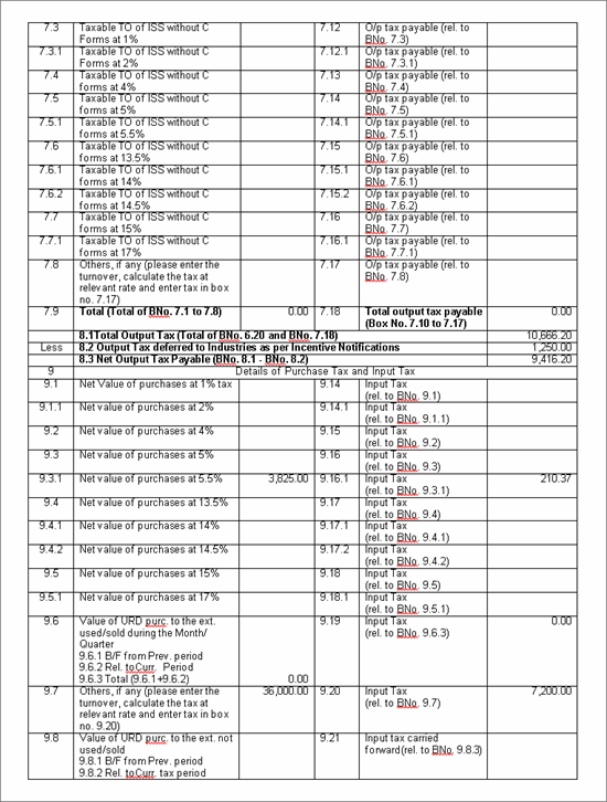

Form VAT 100 - Page 2

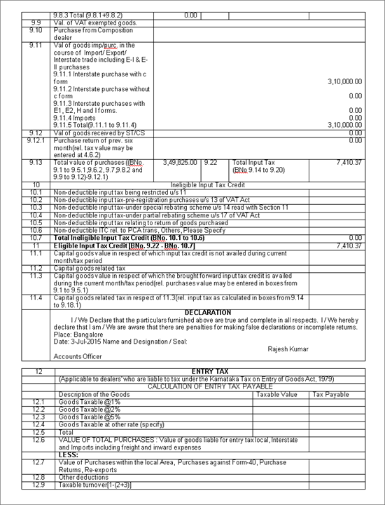

Form VAT 100 - Page 3

1. General Information:
1.1 LVO/VSO CODE:
Displays the LVO/VSO Code entered under Additional Information section in Company VAT Details screen of Statutory & Taxation features.
1.2 Tax Period (Month/Quarter):
Displays the Month or Quarter is with the year depending on the From and To dates entered in the Form VAT 100 report.
1.3 Type of Return:
Displays the Type of Return selected in Karnataka VAT Return 100 Printing screen.
1.4 Date of filing return:
Displays the date of filing entered in the Date field of Karnataka VAT Return 100 Printing screen.
1.5 TIN:
Displays the TIN entered in the Company VAT Details screen of Statutory & Taxation features.
1.6 Full Name of the Dealer:
Displays the Mailing Name entered in the Company Creation screen.
1.7 Address of the dealer:
Displays the Address entered in the Company Creation screen.
1.8 Tax invoices issued in a month*:
Displays the first number and last number of the tax invoices.
PARTICULARS OF TURNOVERS - Local
2. Total Turnover
Displays the total turnover of sales made within the state.
2.1 Ret., disc., lab. chg. etc rel.  to sales of the month
Displays the values entered in the following transactions:
● Credit Note recorded with Nature of Transaction - Sales Taxable and Sales - Works Contract by selecting Not Applicable as the Nature of Return in the Statutory Details screen of the invoice.
● Discount value entered for discount ledger in sales invoice recorded with Nature of Transaction - Sales - Works Contract .
● Deduction value of sales recorded with Nature of Transaction - Sales - Works Contract .
2.1.1 Sales returns of prev. six month (rel. tax value may be entered at 4.6.1)
Displays the value of credit note recorded with Nature of Transaction - Sales Taxable and Sales - Works Contract by selecting Not Applicable as the Nature of Return in the Statutory Details screen of the invoice.
2.2 Const. Sales/C.A. Sales
Displays the value of sales recorded using the Nature of Transaction - Branch Transfer Outward and Consignment Transfer Outward .
2.3 Tax Coll. (VAT)
Displays the tax amount entered in sales invoice and credit note using the Nature of Transaction - Sales Taxable and Sales - Works Contract .
2.4 Exempted Sales
Displays the value of sales recorded using the Nature of Transaction - Sales Exempt .
2.5 PCA turnover/Others
This field is currently left blank.
2.6 Taxable TO (Local)

● Common CST ledger or CST ledger predefined with 1% CST rate must be selected (grouped under Duties & Taxes with Type of Duty/Tax as CST ).
7.3.1  Taxable TO of ISS without C Forms at 2%
Displays the assessable value of sales recorded using the following Nature of Transactions:
● Interstate Sales - Taxable by selecting stock item predefined with 2% tax rate.
● Interstate Sales - Works Contract by selecting stock item identified as works contract and predefined with 2% tax rate.
The following details must be provided to display the sale value here.
● In Party Details screen:
o A different State should be selected. For example, if Karnataka State is selected in Company VAT Details screen of Statutory & Taxation features, the same State should not be selected in Party Details screen.
o The option Is Against C Form must be set to No .
● A common sales ledger or sales ledger predefined with 2% CST rate must be associated with Nature of Transaction - Interstate Sales - Taxable or Interstate Sales - Works Contract .
● Common CST ledger or CST ledger predefined with 2% CST rate must be selected (grouped under Duties & Taxes with Type of Duty/Tax as CST ).
7.4  Taxable TO of ISS without C forms at 4%
Displays the assessable value of sales recorded using the Nature of Transaction - Interstate Sales - Taxable and Interstate Sales - Works Contract by selecting stock item predefined with 4% tax rate. The following details must be provided to display the sale value here.
● A common sales ledger or sales ledger predefined with 4% CST rate must be associated with Nature of Transaction - Interstate Sales - Taxable .
● Common CST ledger or CST ledger predefined with 4% CST rate must be selected (grouped under Duties & Taxes with Type of Duty/Tax as CST ).
7.5  Taxable TO of ISS without C forms at 5%
● Interstate Sales - Taxable by selecting stock item predefined with 5% tax rate.
● Interstate Sales - Works Contract by selecting stock item identified as works contract and predefined with 5% tax rate.
● A common sales ledger or sales ledger predefined with 5% CST rate must be associated with Nature of Transaction - Interstate Sales - Taxable .
● Common CST ledger or CST ledger predefined with 5% CST rate must be selected (grouped under Duties & Taxes with Type of Duty/Tax as CST ).
7.5.1  Taxable TO of ISS without C forms at 5.5%
● Interstate Sales - Taxable by selecting stock item predefined with 5.5% tax rate.
● Interstate Sales - Works Contract by selecting stock item identified as works contract and predefined with 5.5% tax rate.
● A common sales ledger or sales ledger predefined with 5.5% CST rate must be associated with Nature of Transaction - Interstate Sales - Taxable .
● Common CST ledger or CST ledger predefined with 5.5% CST rate must be selected (grouped under Duties & Taxes with Type of Duty/Tax as CST ).
7.6  Taxable TO of ISS without C forms at 13.5%
Displays the assessable value of sales recorded using the Nature of Transaction - Interstate Sales - Taxable and Interstate Sales - Works Contract by selecting stock item predefined with 13.5% tax rate. The following details must be provided to display the sale value here.
● A common sales ledger or sales ledger predefined with 13.5% CST rate must be associated with Nature of Transaction - Interstate Sales - Taxable .
● Common CST ledger or CST ledger predefined with 13.5% CST rate must be selected (grouped under Duties & Taxes with Type of Duty/Tax as CST ).
7.6.1  Taxable TO of ISS without C forms at 14%
● Interstate Sales - Taxable by selecting stock item predefined with 14% tax rate.
● Interstate Sales - Works Contract by selecting stock item identified as works contract and predefined with 14% tax rate.
● A common sales ledger or sales ledger predefined with 14% CST rate must be associated with Nature of Transaction - Interstate Sales - Taxable .
● Common CST ledger or CST ledger predefined with 14% CST rate must be selected (grouped under Duties & Taxes with Type of Duty/Tax as CST ).
7.6.2  Taxable TO of ISS without C forms at 14.5%
● Interstate Sales - Taxable by selecting stock item predefined with 14.5% tax rate.
● Interstate Sales - Works Contract by selecting stock item identified as works contract and predefined with 14.5% tax rate.
● A common sales ledger or sales ledger predefined with 14.5% CST rate must be associated with Nature of Transaction - Interstate Sales - Taxable .
● Common CST ledger or CST ledger predefined with 14.5% CST rate must be selected (grouped under Duties & Taxes with Type of Duty/Tax as CST ).
7.7  Taxable TO of ISS without C forms at 15%
Displays the assessable value of sales recorded using the Nature of Transaction - Interstate Sales - Taxable and Interstate Sales - Works Contract by selecting stock item predefined with 15% tax rate. The following details must be provided to display the sale value here.
● A common sales ledger or sales ledger predefined with 15% CST rate must be associated with Nature of Transaction - Interstate Sales - Taxable .
● Common CST ledger or CST ledger predefined with 15% CST rate must be selected (grouped under Duties & Taxes with Type of Duty/Tax as CST ).
7.7.1  Taxable TO of ISS without C forms at 17%
Displays the assessable value of sales recorded using the Nature of Transaction - Interstate Sales - Taxable and Interstate Sales - Works Contract by selecting stock item predefined with 17% tax rate. The following details must be provided to display the sale value here.
● A common sales ledger or sales ledger predefined with 17% CST rate must be associated with Nature of Transaction - Interstate Sales - Taxable .
● Common CST ledger or CST ledger predefined with 17% CST rate must be selected (grouped under Duties & Taxes with Type of Duty/Tax as CST ).
7.8  Others, if any (please enter the turnover, calculate the tax at relevant rate and enter tax in box no. 7.17)
Displays the assessable value of sales recorded using the Nature of Transaction - Interstate Sales - Taxable and Interstate Sales - Works Contract by selecting stock item predefined with tax rates other than the rates specified in box 7.1 to 7.7.1 (for example, 15.65%, 20%, 25% and 28%). The following details must be provided to display the sale value here.
● A common sales ledger or sales ledger predefined with CST rate other than the rates specified in box 7.1 to 7.7.1 must be associated with Nature of Transaction - Interstate Sales - Taxable .
● Common CST ledger or CST ledger predefined with CST rate other than the rates specified in box 7.1 to 7.7.1 must be selected (grouped under Duties & Taxes with Type of Duty/Tax as CST ).
7.9  Total (Total of BNo. 7.1 to 7.8)
Displays the total of box 7.1 + 7.2 + 7.3 + 7.4 + 7.5 + 7.6 + 7.7 +7.8.
7.10   O/p tax payable (rel. to BNo. 7.1)
Displays the CST calculated at 1% tax rate on amount displayed in box 7.1.
7.11  O/p tax payable (rel. to BNo. 7.2)
Displays the CST calculated at 2% tax rate on amount displayed in box 7.2.
7.12  O/p tax payable (rel. to BNo. 7.3)
Displays the CST calculated at 1% tax rate on amount displayed in box 7.3.
7.12.1  O/p tax payable (rel. to BNo. 7.3.1)
Displays the CST calculated at 2% tax rate on amount displayed in box 7.3.1.
7.13  O/p tax payable (rel. to BNo. 7.4)
Displays the CST calculated at 4% tax rate on amount displayed in box 7.4.
7.14  O/p tax payable (rel. to BNo. 7.5)
Displays the CST calculated at 5% tax rate on amount displayed in box 7.5.
7.14.1  O/p tax payable (rel. to BNo. 7.5.1)
Displays the CST calculated at 5.5% tax rate on amount displayed in box 7.5.1.
7.15  O/p tax payable (rel. to BNo. 7.6)
Displays the CST calculated at 13.5% tax rate on amount displayed in box 7.6.
7.15.1  O/p tax payable (rel. to BNo. 7.6.1)
Displays the CST calculated at 14% tax rate on amount displayed in box 7.6.1.
7.15.2  O/p tax payable (rel. to BNo. 7.6.2)
Displays the CST calculated at 14.5% tax rate on amount displayed in box 7.6.2.
7.16  O/p tax payable (rel. to BNo. 7.7)
Displays the CST calculated at 15% tax rate on amount displayed in box 7.7.
7.16.1  O/p tax payable (rel. to BNo. 7.7.1)
Displays the CST calculated at 17% tax rate on amount displayed in box 7.7.1.
7.17  O/p tax payable (rel. to BNo. 7.8)
The CST calculated at any other rate (for example, 15.65%, 20%, 25% and 28%) on amount displayed in box 7.8 appears here.
7.18  Total output tax payable (Box No. 7.10 to 7.17)
The total tax payable [Box 7.10 + 7.11 + 7.12 + 7.12.1 + 7.13 + 7.14 + 7.14.1 + 7.15 + 7.15.1 + 7.15.2 + 7.16 + 7.16.1 + 7.17] is displayed here.
8.1  Total Output Tax (Total of BNo. 6.20 and BNo. 7.18)
Displays the total amount of output VAT and CST payable [box 6.20 + 7.18].
8.2  Output Tax deferred to Industries as per Incentive Notifications
Displays the value of journal voucher recorded using J : Stat Adjustment button by selecting:
● Decrease of Output Tax as the Nature of Adjustment .
● Tax Deferred in Additional Details option.
Debit: Output VAT (grouped under Duties & Taxes with Type of Duty/Tax as VAT ).
Credit: Tax Deferred ledger (grouped under Current Liabilities ).
The value entered for output VAT ledger appears here.
8.3  Net Output Tax Payable (BNo. 8.1 - BNo. 8.2)
Displays the net output VAT (box 8.1 - 8.2).
9.  Details of Purchase Tax and Input Tax
9.1  Net Value of purchases at 1% tax
Displays the assessable value of purchases recorded using the Nature of Transaction - Purchase Taxable and Purchase - Works Contract by selecting stock item predefined with 1% tax rate.
9.1.1  Net value of purchases at 2%
Displays the assessable value of purchases recorded using the Nature of Transaction - Purchase Taxable and Purchase - Works Contract by selecting stock item predefined with 2% tax rate.
9.2  Net value of purchases at 4%
Displays the assessable value of purchases recorded using the Nature of Transaction - Purchase Taxable and Purchase - Works Contract by selecting stock item predefined with 4% tax rate.
9.3  Net value of purchases at 5%
Displays the assessable value of purchases recorded using the Nature of Transaction - Purchase Taxable and Purchase - Works Contract by selecting stock item predefined with 5% tax rate.
9.3.1  Net value of purchases at 5.5%
Displays the assessable value of purchases recorded using the Nature of Transaction - Purchase Taxable and Purchase - Works Contract by selecting stock item predefined with 5.5% tax rate.
9.4  Net value of purchases at 13.5%
Displays the assessable value of purchases recorded using the Nature of Transaction - Purchase Taxable and Purchase - Works Contract by selecting stock item predefined with 13.5% tax rate.
9.4.1  Net value of purchases at 14%
Displays the assessable value of purchases recorded using the Nature of Transaction - Purchase Taxable and Purchase - Works Contract by selecting stock item predefined with 14% tax rate.
9.4.2  Net value of purchases at 14.5%
Displays the assessable value of purchases recorded using the Nature of Transaction - Purchase Taxable and Purchase - Works Contract by selecting stock item predefined with 14.5% tax rate.
9.5  Net value of purchases at 15%
Displays the assessable value of purchases recorded using the Nature of Transaction - Purchase Taxable and Purchase - Works Contract by selecting stock item predefined with 15% tax rate.
9.5.1  Net value of purchases at 17%
Displays the assessable value of purchases recorded using the Nature of Transaction - Purchase Taxable and Purchase - Works Contract by selecting stock item predefined with 17% tax rate.
9.6 Value of URD purc. to the ext. used/sold during the Month/ Quarter
9.6.1  B/F from Prev. period
Displays the transaction recorded in journal voucher using J : Stat Adjustment button by selecting:
● Input Tax Adjustment for Purchases From URDs as the Nature of Adjustment .
● Previous Period in Additional Details option.
Debit: Input VAT ledger (grouped under Duties & Taxes with Type of Duty/Tax as VAT ).
Credit: Tax paid on Purchases from URD (grouped under Current Assets).
9.6.2  Rel. to Curr. Period
● Not Applicable in Additional Details option.
Debit: Input VAT ledger (grouped under Duties & Taxes with Type of Duty/Tax as VAT ). The assessable value entered for VAT ledger in VAT Details screen is captured here.
9.6.3 - Total (9.6.1+9.6.2)
9.7  Others, if any (please enter the turnover, calculate the tax at relevant rate and enter tax in box no. 9.20)
Displays the value of purchases made using the Nature of Transaction Purchase Taxable and Purchase - Works Contract for 12.5%, 15.65, 20%, 25% and 28% VAT rates.
9.8  Value of URD purc. to the ext. not used/sold
9.8.1  B/F from Prev. period
Displays the amount captured in box 9.6.3.
● Opening Balance of Purchase Tax as the Nature of Adjustment .
Credit: Ledger grouped under Current Assets.
9.8.2  Rel. to Curr. tax period
Displays the transaction recorded in journal voucher using J : Stat Adjustment button by selecting Tax on URD Purchase as the Nature of Adjustment . Assessable value entered for purchase tax ledger in VAT Details screen appears here.
9.8.3  Total (9.8.1+9.8.2)
9.9  Val. of VAT exempted goods
Displays the value of purchases recorded using the Nature of Transaction - Purchase Exempt and Interstate Purchase Exempt .
9.10  Purchase from Composition dealer
Displays the value of purchases made using the Nature of Transaction - Purchase From Composition Dealer .
9.11  Val of goods imp/purc. in the course of  Import/ Export/ Interstate trade including E-I & E-II purchases
9.11.1  Interstate purchase with C form
Displays the assessable value of purchases recorded using the Nature of Transaction Interstate Purchase - Against Form C and Interstate Purchase Exempt - With Form C (the option Is under CST exemption? is set to Yes ).
o The option Is Against C Form must be set to Yes .
● In Statutory Details screen (displayed on enabling the option Provide VAT Details ) the option Form to receive must be set to C Form .
9.11.2  Interstate purchase without C form
Displays the assessable value of purchases recorded using the Nature of Transaction Interstate Purchase .
● A common purchase ledger or purchase ledger predefined with 2% CST rate must be associated with Nature of Transaction - Interstate Purchase - Against Form C .
9.11.3  Interstate purchases with E1, E2, H and I forms
Displays the assessable value of purchases recorded using the Nature of Transaction Interstate Purchase - E2 , Interstate Purchase Exempt - E1 , Interstate Purchase Deemed Export , and Interstate Purchase Exempt - With Form C (the option Is under CST exemption? set to No ).
o The option Is Against C Form must be set to Yes for the Nature of Transaction Interstate Purchase - E2 . It should be set to No if the Nature of Transaction Interstate Purchase Deemed Export is selected.
● In Statutory De t ails screen (displayed on enabling the option Provide VAT Details ) the relevant form must be selected in the option Form to receive .
9.11.4  Imports
Displays the value of purchases recorded using the Nature of Transaction - Imports .
9.11.5  Total (9.11.1 - 9.11.4)
9.12  Val of goods received by ST/CS
Displays the value of purchases made using the Nature of Transaction - Consignment Transfer Inward , Branch Transfer Inward , Interstate Branch Transfer Inward and Interstate Consignment Transfer Inward .
9.12.1 Purchase return of prev. six month (rel. tax value may be entered at 4.6.2)
Displays the assessable value from purchase returns recorded in the current quarter against purchase invoices from within six months preceding the reporting period.
The assessable value purchase returns, excluding tax values, recorded with the following Nature of transaction are displayed here.
● Branch Transfer Inward
● Consignment Transfer Inward
● Purchase Exempt
● Purchase Taxable
● Purchase - Works Contract
● Purchase From Composition Dealer
● Purchase Taxable - Capital Goods
The assessable value purchase returns, including tax values, recorded with the following Nature of transaction are displayed here.
● Imports
● Interstate Branch Transfer Inward
● Interstate Consignment Transfer Inward
● Interstate Purchase Deemed Export
● Interstate Purchase - Against Form C
● Interstate Purchase - E2
● Interstate Purchase Exempt
● Interstate Purchase Exempt - E1
9.13  Total value of purchases ((BNo. 9.1 to 9.5.1,9.6.2, 9.7,9.8.2 and 9.9 to 9.12)-9.12.1)
Displays the total purchase value.
9.14  Input Tax (rel. to BNo. 9.1)
Displays the input VAT calculated at 1% tax rate on the amount captured in box 9.1.
9.14.1  Input Tax (rel. to BNo. 9.1.1)
Displays the input VAT calculated at 2% tax rate on the amount captured in box 9.1.1.
9.15  Input Tax (rel. to BNo. 9.2)
Displays the input VAT calculated at 4% tax rate on the amount captured in box 9.2.
9.16  Input Tax (rel. to BNo. 9.3)
Displays the input VAT calculated at 5% tax rate on the amount captured in box 9.3.
9.16.1  Input Tax (rel. to BNo. 9.3.1)
Displays the input VAT calculated at 5.5% tax rate on the amount captured in box 9.3.1.
9.17  Input Tax (rel. to BNo. 9.4)
Displays the input VAT calculated at 13.5% tax rate on the amount captured in box 9.4.
9.17.1  Input Tax (rel. to BNo. 9.4.1)
Displays the input VAT calculated at 14% tax rate on the amount captured in box 9.4.1.
9.17.2  Input Tax (rel. to BNo. 9.4.2)
Displays the input VAT calculated at 14.5% tax rate on the amount captured in box 9.4.2.
9.18  Input Tax (rel. to BNo. 9.5)
Displays the input VAT calculated at 15% tax rate on the amount captured in box 9.5.
9.18.1  Input Tax (rel. to BNo. 9.5.1)
Displays the input VAT calculated at 17% tax rate on the amount captured in box 9.5.1.
9.19  Input Tax (rel. to BNo. 9.6.3)
Displays the value of journal voucher recorded using J : Stat Adjustment button with the following Nature of Adjustments .
● Input Tax Adjustment for purchases from URDs as Nature of Adjustment with Previous Period in the field Additional Details .
● Input Tax Adjustment for purchases from URDs as Nature of Adjustment .
Debit : Input VAT ledger (grouped under Duties & Taxes , Type of Duty/Tax set to VAT ).
Credit : Tax paid on Purchases from URD (grouped under Current Assets).
Debit value of input VAT ledger appears here. It is the tax calculated on the amount captured in box 9.6.3.
9.20  Input Tax (rel. to BNo. 9.7)
Displays the input VAT calculated on the amount captured in box 9.7.
9.21  Input tax carried forward (rel. to BNo. 9.8.3)
Displays the input VAT amount specified in journal voucher recorded using J : Stat Adjustment button by selecting Input Tax Adjustment for Purchases from URDs as the Nature of Adjustment field.
The journal entry is given below:
Select Input Tax Adjustment for Purchases from URDs is selected as the Nature of Adjustment .
Debit: Input VAT ledger (grouped under Duties and Taxes with the Type of Duty/Tax as VAT ).
9.22  Total Input Tax (BNo 9.14 to 9.20)
10. Ineligible Input Tax Credit
10.1  Non-deductible input tax being restricted u/s 11
● Reversal of Input Tax as the Nature of Adjustment .
● Under Section 11 in Additional Details option.
Debit: Non Deductible ITC ledger (grouped under Indirect Expenses).
Credit: Input VAT ledger (grouped under Duties and Taxes with the Type of Duty/Tax as VAT ).
Input VAT amount is displayed here.
10.2  Non-deductible input tax-pre-registration purchases u/s 13 of VAT Act
● Pre-Registration Purchases in Additional Details option.
Refer 10.1 for journal entry.
10.3  Non-deductible input tax-under special rebating scheme u/s 14 read with Section 11
● Special Rebating in Additional Details option.
10.4  Non-deductible input tax-under partial rebating scheme u/s 17 of VAT Act
● Partial Rebating in Additional Details option.
10.5  Non-deductible input tax relating to return of goods purchased
● Purchase Return in Additional Details option.
10.6  Non-deductible ITC rel. to PCA trans, Others, Please Specify
10.7  Total Ineligible Input Tax Credit (BNo. 10.1 to 10.6)
11.  Eligible Input Tax Credit [BNo. 9.22 - BNo. 10.7]
Declaration
Displays the Name , Status/Designation , Place and Date specified in Print Report screen of Form VAT 100 in respective fields of this section.
12. Entry Tax
This section is currently left blank.
13. SPECIAL ENTRY TAX
