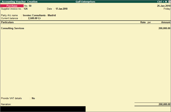

Import of Services
You can account for the import of services by using a purchase invoice, raise tax liability in your books of accounts, and then pay it to the department. Since no goods are involved here, record the purchase as an accounting voucher.
2. Click I : Accounting Invoice .
3. In Party's A/c Name , select the service provider belonging to a country outside GCC.
4. Under Particulars , select the service ledger grouped under Purchase Accounts , with Imports Taxable as the Nature of transaction and Services as the Type of supply .
5. Press F12: Configure .
o Enable the option Provide VAT details?
o Enter the Import Permit Number .
o Press Enter to return to the purchase screen.
6. Press Ctrl+A to accept.
