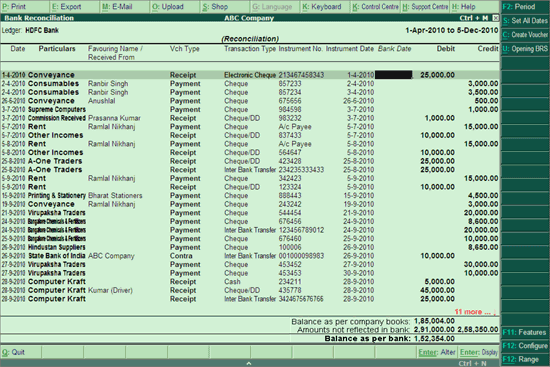

1. Go to Gateway of Tally > Banking > Bank Reconciliation .
2. Select the required Bank account from the List of Bank and press Enter . The Bank Reconciliation screen of the selected Bank appears. By default the details in the Bank Reconciliation screen are sorted based on Bank Date (if bank date is already specified for the transaction). Or else, such sorting will be based on the Instrument Date .
Note:
♦ The Bank Reconciliation screen can also be accessed from Gateway of Tally > Display > Accounts Books > Cash/Bank Books > Select Bank Ledger > Select a month > F5: Reconcile.
♦ By default, the screen displays the period range from date specified in the Effective Date for Reconciliation in the Bank ledger master till the date of last entry.
♦ The Bank Date has be to be provided based on the Instrument Date and not on Voucher Date.

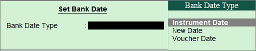

● S : Set Bank Dates : To set a bank date for all the transactions for reconciliation, click S : Set Bank Dates button or press Alt+S key. The Set Bank Date sub-screen appears as shown:
o Instrument Date: On selecting Instrument Date as the Bank Date Type , the Bank Date field for all the transactions in the Bank Reconciliation screen is filled with the instrument date entered for that transaction in the Bank Allocations screen.
o New Date: On selecting New Date as the Bank Date Type , a new field Date appears in the Set Bank Date sub-screen.
o Specify the required bank date that is to be filled for all the transactions in the Bank Reconciliation screen.
o Voucher Date : On selecting Voucher Date as the Bank Date Type , the Bank Date field for all the transactions in the Bank Reconciliation screen is filled with the Date of Voucher .

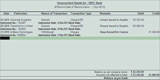

● U : Opening BRS : Click this button to provide opening BRS to the unreconciled transactions. The Opening Bank Allocation screen for the selected Bank appears as shown:
o Provide the unreconciled transaction details based on the nature of transactions  (Deposit/Withdrawal) as shown:

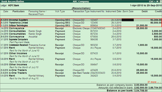

o Save the screen. The Bank Reconciliation screen with opening BRS appears as shown:
Note: When the company data is split , the unreconciled transactions will automatically get updated in the Opening BRS details. You can remove those details , if required.
o Provide the date of the realised transactions (the amount reflecting in the bank passbook) in the Bank Date field provided.
o Save the Bank Reconciliation screen.
Note: When the user tries to access F12 : Range for filters in the Bank Reconciliation screen, will prompt to Accept the current screen before proceeding.
o Press Ctrl+Enter on the required transaction row to open the voucher in alteration mode.

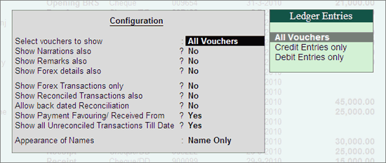

You can configure the Bank Reconciliation screen based on his requirement. Press F12: Configure. The Configuration screen appears as follows:
● Select vouchers to show : By default, all the vouchers are displayed. Select the required Ledger Entries type from the list.
● Show Narrations also : Set this option to Yes to display the narration in the Bank Reconciliation screen.
● Show Remarks also : Set this option to Yes to display the remarks in the Bank Reconciliation screen as shown:
● Show Forex details also : Set this option to Yes to display the forex details also in the report.
● Show Forex Transactions only : By default, this option is set to Yes . The cheque printing screen displays only the Forex transaction.
Note: The options Show Forex details also and Show Forex Transactions only appear only in case Multi Currency feature is enabled for the company.
● Show Reconciled Transactions also : Set this option to Yes to display the reconciled transactions also in the Bank Reconciliation screen.
● Allow Back dated Reconciliation : Set this option to Yes to allow reconciling back dated transactions also.

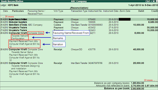

● Show Payment Favouring/Received From : Set this option to Yes to display the Payment Favouring / Received From details in the Bank Reconciliation screen. The Bank Reconciliation screen with Narration , Remarks and Payment Favouring / Received From details is displayed, as shown:
Note:
♦ The Favouring Name column displays only those names which are different from the Party/Ledger account names.
♦ Bank Reconciliation capability has been enhanced, from this screen users can
* View the voucher display by pressing Alt+Enter from Bank Date field
* Alter the Voucher by pressing Ctrl+Enter from Bank Date field
