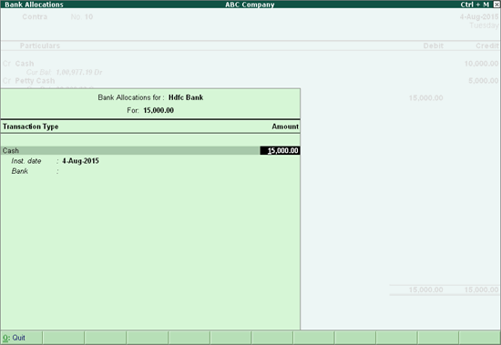

In the Bank Allocation screen, users can select the mode of transaction from the List of Transaction Type as shown:
By default, Cheque/DD will be selected.

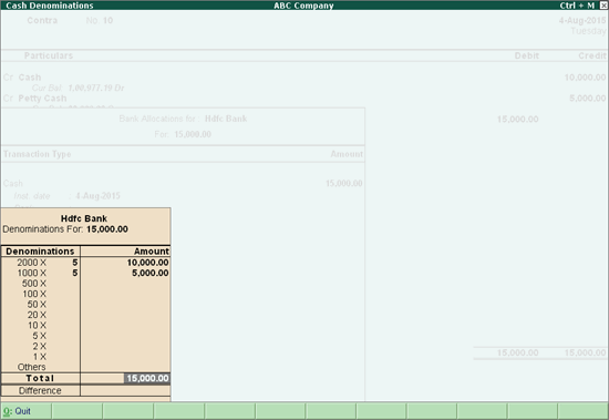

When Cash is selected as the Transaction Type, a new screen – Cash Denominations.
The cash denominations entered here will be captured in the Cash Denomination details while printing a Cash Deposit Slip for this transaction.
Note: Cash denomination of 2000 is supported from Release 5.4.8.
The Difference field will give the difference between the total and the sum of amounts specified for the Denominations.
Note: If the cash is transferred to more than one bank, then for each bank a separate Cash Denominations screen will appear.
