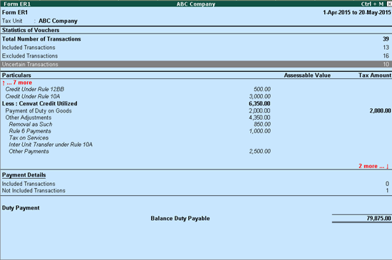

Generating Form ER 1 (Excise for Manufacturer)
Form ER 1 is a monthly return for production, removal of goods, other relevant particulars and CENVAT Credit. All the Excise Manufacturing (Regular/Large Tax payer) Units should file returns in Form ER 1. Form ER 1 is an excise unit wise report. This report provides complete information on the assessable value of all clearances, CENVAT credit availed and utilized, balance duty payable and the duty paid for a particular month.
The report can be drilled down to the voucher entry level to display complete information of each transaction.
To generate the Form ER1
1. Go to Gateway of Tally > Display > Statutory Reports > Excise Reports > Manufacturer > Excise Forms > Form ER 1 .
2. Click F1 : Detailed .
Form ER1 appears as shown below:

The Balance CENVAT Credit Available displays the amount computed by deducting the CENVAT Credit Utilised from the CENVAT Credit Availed appears as. The Duty Payable after CENVAT Adjustment displays the duty liability computed by deducting the Balance CENVAT Credit Available from the total Duty Payable amount.
