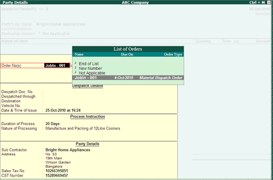

4. Party A/C Name : In this field select the Principal Manufacturer ledger  to whom the Finished goods to be delivered. E.g. Bright Home Appliances . Press Enter to view Party Details screen.
5. In Party Details screen,
● Under Order Details , in Order No(s) field select the Job Order from the List of Orders towards which the finished goods are delivered.
● Under Party's Document Details , in Challan Number field enter the delivery challan number through which the finished goods are delivered and mention the challan date.
Note :
1. The Order Type in List of Orders will be displayed as Material Dispatch Order indicating that this order is selected to account the despatch of Finished Goods.
2. The Duration of Process and Nature of Processing specified in Job Work In Order will be displayed automatically based on the Order selected.

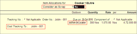

8. Under Name of Item , select the stock item - Cooker 12Litre and press enter to view Stock Item Allocation screen.
9. In Stock Item Allocation screen,
● Retain No for the option Consider as Scrap.
Note : if the Goods delivered is a Scrap set the option Consider as Scrap to Yes .
10. In Cost Tracking To field select JobIn - 001 to track the cost against the Job order JobIn - 001 to manufacture Cooker 12Litre .

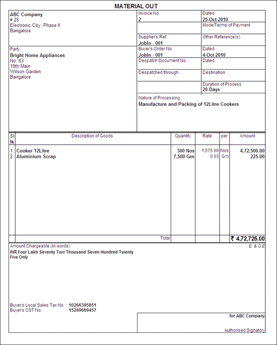

The Finished goods produced have to be delivered to Principal Manufacturer along with Delivery Document (Delivery Challan).
For Material out transaction recorded for accounting the delivery of finished goods, users can generate Delivery Document (Delivery Challan).
To Print the Delivery Document
● Press Page up to view the material transfer Out voucher recorded earlier.
● Press Alt + P or Click on P : Print button to view the Voucher Printing screen.
● Press Enter to view the print preview of Material Out Challan.

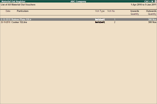

The details of Material Transfer Out voucher recorded to account the delivery of finished goods can be viewed in Material Out Transfer report.
To view the Material Out Transfer
Go to Gateway of Tally > Display > Job Work In Reports > Job Work Registers > Material Out Transfer

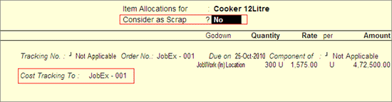

6. Under Name of Item , select the stock item and press enter to view Stock Item Allocation screen
7. In Stock Item Allocation screen, select the Cost Tracking Number.
