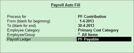

3. Click A : Payroll Auto Fill .
4. Select the required process in the Process for field.
5. Enter the From and To date.
6. Select the appropriate Employee Category .
7. Select the Employee/Group from the List of Employees/Group .
8. Select the appropriate Payroll Ledger from the List of Ledger Accounts .

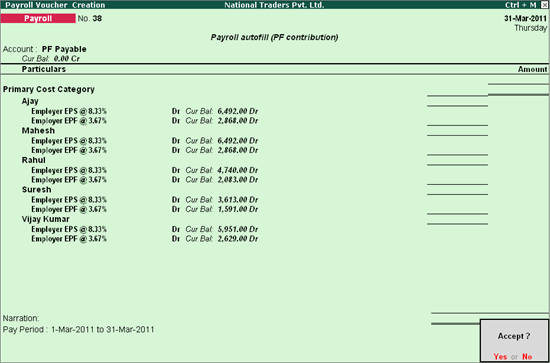

9. Press Enter to open the Payroll Voucher Creation screen.
10. By default, the Amount field is pre-filled with values.
11. Narration is pre-filled with the Pay Period . You can change or add to the Narration .
12. Press Enter to save
