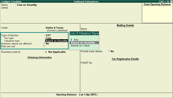

Create cess ledger
You can create separate cess ledgers for quantity and value, to print the breakup of these values in the invoice. Do not alter the existing cess ledgers as it will impact the transactions recorded earlier.
2. In Under , select Duties & Taxes .
3. Select GST as the Type of duty/tax .
4. Select Cess as the Tax type .
5. Select the valuation type as:
o Based on Quantity to calculate cess on quantity.
o Based on Value to calculate cess on the assessable value.
Note: Set the Valuation Type to Any to use it as a common ledger.
