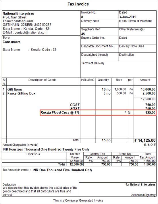

When this ledger is selected in the invoice, KFC is calculated on the taxable value of all items.
Record Invoice with Kerala Flood Cess
2. In Party A/c name , select the customer ledger or the cash ledger.
3. Select the sales ledger.
4. Select the required items, and specify the quantities and rates.
5. Select the central and state tax ledgers.
6. Select the Kerala Flood Cess ledger. Cess is calculated on the total sales value and appears automatically.
7. Save the invoice.
When you print the invoice with Kerala Flood Cess applied, the details of the ledger and cess value appear in the invoice copy as shown below:

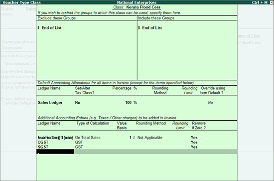

Create Voucher Class

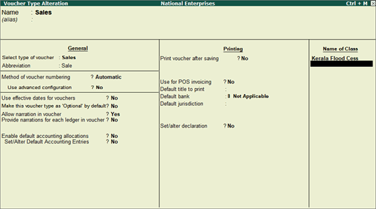

1. Go to Gateway of Tally > Accounts Info. > Voucher Types > Alter .
2. Select Sales from the List of Voucher Types .
3. Navigate to Name of Class and enter a name for the Voucher Class.
4. In the Voucher Type Class screen;
o Under Default Accounting Allocations for all items in Invoice (except for the items specified below) , select the common sales ledger used in the sales transaction.
o Set the Percentage % to 100% .
o Under Additional Accounting Entries (e.g. Taxes/Other charges) to be added in Invoice , select the Kerala Flood Cess ledger in the Ledger Name column.
o Select the option On Total Sales in the Type of Calculation column.
o Enter 1 as the Value Basis .
o Set Remove if Zero? to Yes . This will remove the ledger from the invoice in case the ledger value is zero.
o Select CGST and SGST ledgers in the Ledger Name column.
o Save the voucher class settings
5. Save the voucher type.

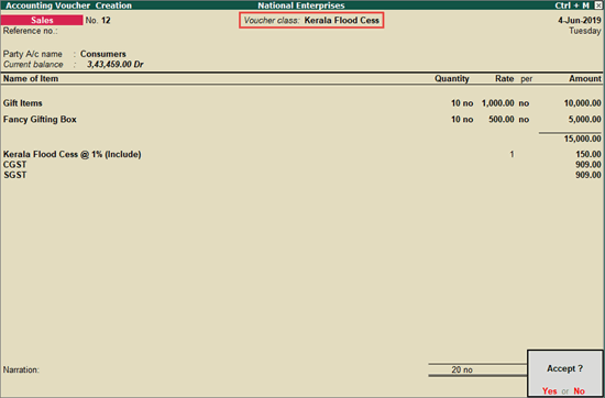

Record Invoice using Voucher Class
2. Select the voucher class in the Change Voucher Type screen.
3. In Party A/c name , select the customer ledger or the cash ledger.
4. Select the required items, and specify the quantities and rates. The values for Kerala Flood Cess, CGST, and SGST appear automatically against the respective ledgers based on the rates configured.
5. Save the invoice.
Similarly, you can use the voucher class to create invoice for services.

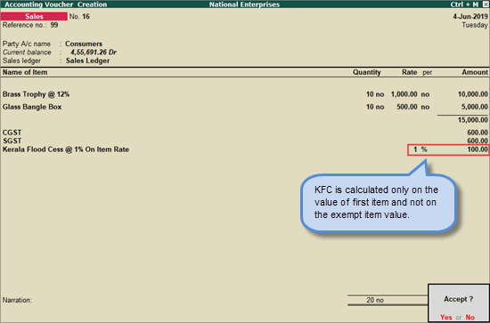

Invoice with Taxable (attract KFC) and Exempt Goods
Businesses handling goods that attract additional cess and exempt can use this method. This is especially useful in cases where goods that attract tax and exempt are selected in a single invoice. Since only few item attract cess, you have to configure the percentage in the respective item master. Also, configure the cess ledger created to calculate tax on item rate.
To setup Tally.ERP for invoicing items with and without cess, alter the item masters of goods that attract cess and specify the rate and create ledgers for each cess percentage and configure method of calculation based on item rate.
In this section
Update Item Master
Create Kerala Flood Cess ledger
Apply KFC in Sales Transaction
Update Item Master
1. Go to Gateway of Tally > Inventory Info. > Stock Items > Alter > select the item.
2. Enter the Cess percentage in the Rate of Duty (eg 5) field. Please note that this is not the GST percentage but only the additional Cess.
3. Save the item master.
Note : You don't have to alter the item which does not attract any tax. Cess is calculated only on items in which rate of duty is configured.
2. In Under , select Duties & Taxes .
3. Select Others as the Type of duty/tax .
4. Enter the Cess percentage in the Percentage of calculation field.
5. Select the option Tax based on Item Rate in the Method of calculation field.
6. Save the ledger.
When this ledger is selected in the invoice, the tax is calculated based on the Cess rate defined in the item master. Since tax rates are derived from the respective masters Cess is calculated only for applicable items and exempt items are excluded.
4. Select the required item on which KFC is applicable, and specify the quantity and rate.
5. Select the item on which KFC is not applicable, and specify the quantity and rate.
6. Select the central and state tax ledgers.
7. Select the KFC ledger. Kerala Flood Cess is calculated only for the applicable item, the other item is excluded as it is a not taxable.
8. Save the invoice.
This method is recommended for transactions with taxable and exempt items in a single invoice but not for taxable and exempt services.

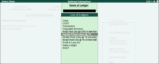

View Kerala Flood Cess ledger report
1. Go to Gateway of Tally > Display > Account Books > Ledger .
2. Select the additional Cess ledger and press Enter .
In case you have created multiple ledgers to manage Kerala Flood Cess, view the ledger report for each and get ledger balance to calculate the total cess payable.

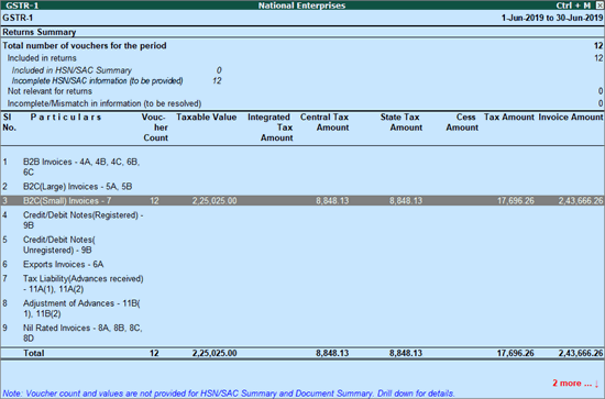

View GSTR-1 to get Taxable Value for Kerala Flood Cess
1. Go to Gateway of Tally > Display > Statutory Reports > GST > GSTR-1 .
2. Drill down from B2C (Small) Invoices - 7 to get the rate wise taxable value.
