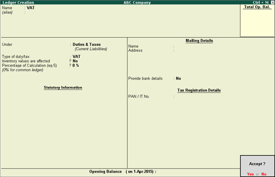

VAT Ledger - Duties & Taxes
To create a common VAT ledger
2. Enter the Name of the VAT ledger.
3. Select Duties & Taxes in the Under field.
4. Select Type of duty/tax as VAT .
5. Press Enter to skip the Percentage of Calculation field, to create VAT ledger without specific rate.
Note: To create a VAT ledger with a specific rate, enter the tax rate in the Percentage of Calculation field.
6. Press Enter to save.

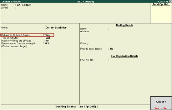

VAT Ledger - Current Assets or Current Liabilities
To create a tax ledger grouped under Current Assets
3. Select Current Assets or Current Liabilities in the Under field.
4. Click F12: Configure .
o Enable the option Allow creation of tax ledgers under other groups?
o Press Ctrl+A to accept the Master Configuration screen.
5. Enable the option Behave as Duties & Taxes? .
6. Select VAT as the Type of duty/tax .
7. Enter the VAT rate in the Percentage of Calculation field, if the rate specific VAT ledger has to be created. The Ledger Creation screen appears as shown below:
8. Press Enter to save.
Similarly, you can create a CST ledger under Current Assets or Current Liabilities by selecting CST as the Type of duty/tax .

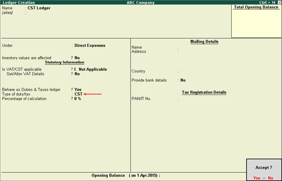

CST ledger grouped under Purchase Accounts or Direct Expenses for apportioning
To create a CST ledger grouped under Purchase Accounts or Direct Expenses for apportioning
2. Enter the Name of the CST ledger.
3. Select Purchase Accounts or Direct Expenses in the Under field.
o Press Ctrl+A to save the Master Configuration screen.
5. Set the option Is VAT/CST applicable? to Not Applicable .
6. Set the option Include in assessable value calculation for to Not Applicable .
7. Enable the option Behave as Duties & Taxes? .
8. Select CST as the Type of duty/tax .
9. Enter the CST rate in Percentage of Calculation field, if the rate specific VAT ledger has to be created. The Ledger Creation screen appears as shown below:
10. Press Enter to save.

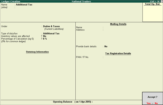

Additional Tax Ledger
To create an additional tax ledger for Gujarat or Uttar Pradesh VAT
2. Enter the Name of the additional tax ledger.
4. Select Types of duty/tax as Additional Tax .
5. Press Enter to skip the Percentage of Calculation field.

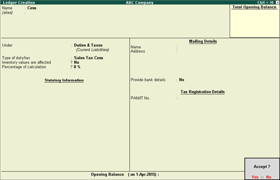

Cess Ledger
To create a cess ledger for Kerala and Uttarakhand VAT
2. Enter the Name of the cess ledger.
4. Select Types of duty/tax as Sales Tax Cess .
Note: For Uttarakhand VAT, cess on quantity is not supported.

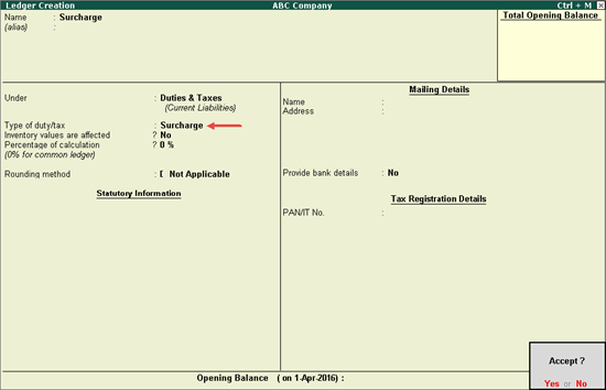

Surcharge Ledger
To create a surcharge ledger for Punjab and Haryana
4. Select Types of duty/tax as Surcharge .

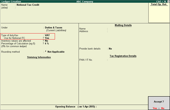

VAT Ledger - Notional Input Tax Credit
To create a ledger for notional input tax credit
4. Select Types of duty/tax as VAT .
5. Set the option Use for Notional ITC to Yes .
6. The field Percentage of Calculation displays 4%. The Ledger Creation screen appears as shown below:
7. Press Enter to save.
