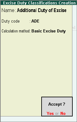

To create an Excise Duty Classification,
1. Go to Gateway of Tally > Accounts Info. > Statutory Info. > Excise Duty Classifications > Create .
2. Enter the Name of the duty classification.
3. Select the applicable Duty code from the List of Excise Duty Codes .
4. Select the Calculation method from the List of Excise Duty Classifications .
The completed Excise Duty Classifications Creation screen appears as shown below:
5. Press Enter to save.
