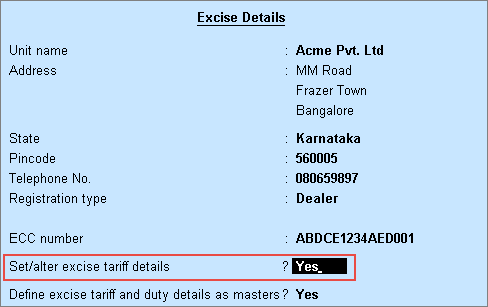

To define tariff rate at the company level
1. Go to Gateway of Tally > F11: Features > F3: Statutory and Taxation .
2. Set the option Enable Excise to Yes .
3. Set the option Set/ Alter Excise Tariff Details to Yes in the Excise Details screen.
4. Enter the excise details and define the duty rate.
5. Press Enter to save.
6. Press Ctrl+A to save the Excise Registration details.

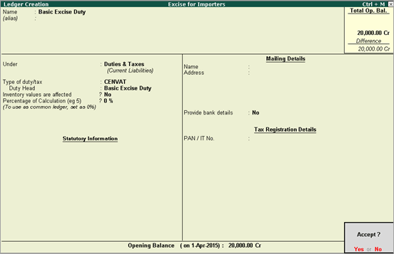

Creating Duty Ledger
● Create a duty ledger with the Type of Duty as CENVAT and the Duty Head as Basic Excise Duty.
