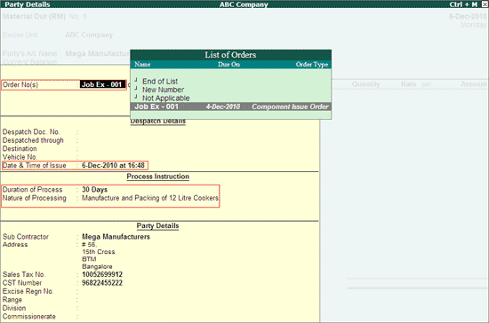

3. Party A/C Name : In this field select the job worker ledger to whom the material to be transferred. Press Enter to view Party Details screen
● In Party Details screen, select the Order No(s) from the List of Orders towards which the raw materials are transferred.
Note: The Order Type in List of Orders will be displayed as Component Issue Order indicating that this order is selected for issue of components.
● Date & Time of Issue :  Displays  the voucher date and system time by default.

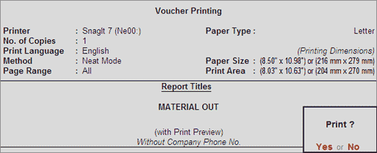

2. Click on Print button or Press Alt + P from the material transfer out voucher to view the Voucher Printing screen.
Note : To view the Material Transfer Out challan in a preview mode, click on I : With Preview button or press Alt + I .
3. Press Enter to accept the Voucher Printing screen and to display the material transfer out challan in print preview mode.

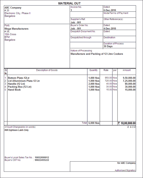

The print preview of the material transfer out challan appears as shown below:
The details of material transfer out voucher details can be viewed in Material Out Register .

3. Enter the Date , select the Party Ledger to whom the material to be transferred. E.g. Mega Manufacturer .
4. In Party Details screen, select the job order - JobEx - 001 n Order No(s) field.
5. Enter the required Date & Time of Issue . This field d isplays the voucher date and system time by default.
Note : 1. The Order Type in List of Orders will be displayed as Component Issue Order indicating that this order is selected for issue of components.
2. Providing details in Duration of Process and Nature of Processing is mandatory if the manufacturer is registered under excise. Because cenvat rule has clearly mentioned that a excise manufacturer can avail cenvat credit on the goods sent for Job Work if the goods are received back in the factory with in 180 days.
3. Rules also makes it clear that to avail the credit manufacturer has to establish from records, challans or memos or any other document that the goods are received back with in 180 days. Hence, date and time of issue details are captured.
Date & Time of Issue will get captured in Annexure II .

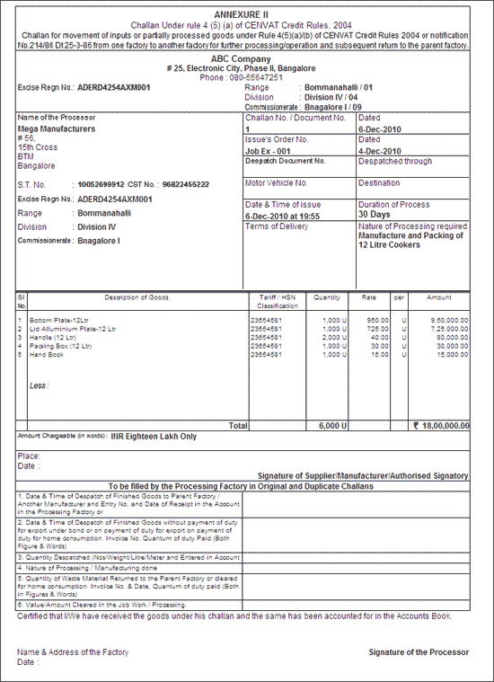

Materials are transfered to job Worker along with Annexure II .  Annexure II (Material Transfer Out Challan) can be generated from material ot voucher.

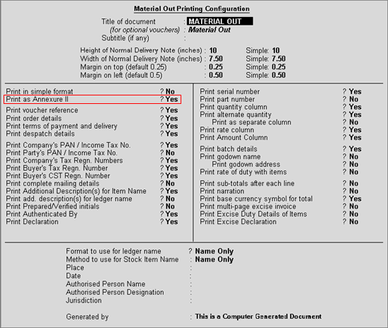

2. Click on Print button or press Alt + P from the material out voucher to view the Voucher Printing screen.
3. Press 12: Configure to view Material Out Printing Configuration screen.
● Set the option Print as Annexure II to Yes .
The Material Out Printing Configuration screen appears as shown below:
Note : To view the Annexure II in a preview mode, click on I : With Preview button or press Alt + I .

The print preview of Annexure II appears as shown below:
In Annexure II, To be filled by the Processing Factory in Original & Duplicate Challan section will be filled by the job worker and returned to the principal manufacturer along with the finished goods.
If the principal manufacturer has agreed to deliver finished goods in installments, the  job worker has to mention the date and time of delivery each installment and return the Annexure II when the last installment is delivered.
