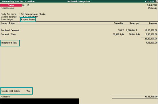

2. In Party A/c name , select the customer ledger.
3. Select the sales ledger. You can also create separate sales ledgers for taxable exports, exempt exports, and exports under LUT/bond, and select them during the transaction.
4. S elect the integrated tax ledger if it is a taxable export.

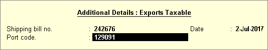

5. Provide GST details - Yes , if you want to enter additional details regarding the export transaction.

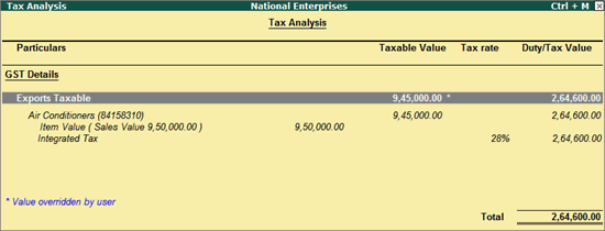

10. Press Alt+A to view the Tax Analysis report.
● In the freight charges ledger, if the options Is GST Applicable is set to No , and Include in Assessable value for is set to Not Applicable , the Tax Analysis appears as shown:

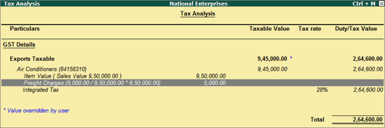

● If the freight charges ledger is appropriated to GST with Method of Calculation set to Based on Value , the Tax Analysis appears as shown:

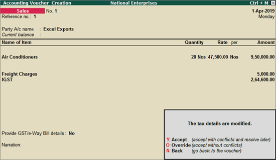

11. Press Esc to return to sales invoice.
12. Press O to override and save the changes made to the assessable value in the transaction.
