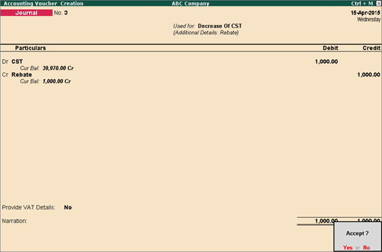

You can create journal vouchers to record decrease in CST value.
2. Click J : Stat Adjustment . In the Stat Adjustment Details screen,
o Select the option VAT in the Type of duty/tax field.
o Select the option Decrease of CST in the Nature of adjustment field.
o Select the option Rebate in Additional Details field.
o Press Enter to save and return to voucher screen.
3. Debit the CST ledger.
o Enter the Rate and Assessable Value in the VAT Details screen.
o Press Enter to return to voucher screen.
4. Enter the amount in the Debit column.
5. Credit the ledger grouped under Indirect Incomes .
6. Set the option Provide VAT Details to Yes and enter the From and To dates, else retain it as No .
7. Enter Narration , if required. The journal voucher appears as shown below:
8. Press Enter to save.
