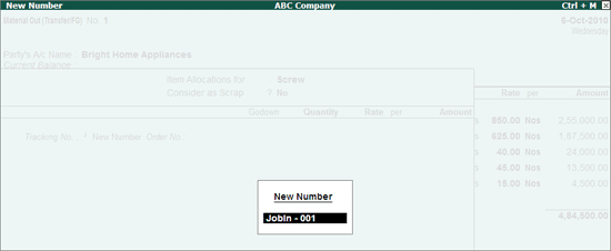

● T racking Number : Job Worker is using his own stock to manufacture the goods. The goods consumed will be billed for the Principal Manufacturer. Hence to track the Raw Materials in sales invoice tracking Number has to specified. Select New Number & specify the tracking as - JobIn - 001 . indicating that these raw materials are consumed to manufacture goods of order JobIn - 001

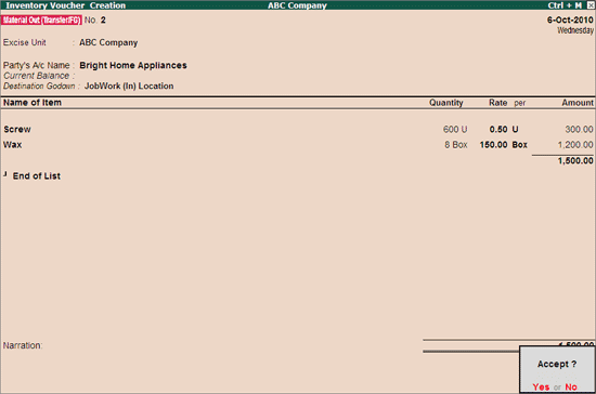

The completed material out voucher is displayed as shown:
11. Press Enter to save.
