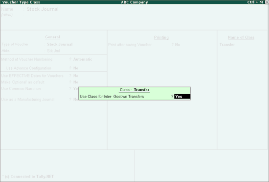

1. Go to Accounts Info > Voucher Types > alter > Stock Journal.
2. Enter a name in the field Name of Class . (for example, Transfer).
3. Class : The Transfer screen is displayed. To create a class for inter - godown transfer, set the option Use Class for Inter -Godown Transfer to Yes .
