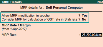

Setting MRP details
To capture the MRP of stock items in the invoice, you have to enter the MRP details in the stock item master.
1. Click F12: Configure in the Stock Item Alteration screen.
2. Allow MRP/Marginal for stock item? - Yes .
3. Press Ctrl+A to accept.
To enter the MRP for the stock item
1. In the Stock Item Alteration screen, enable Set/alter MRP details?
2. In the MRP Details screen:
o Allow MRP modification in voucher? - Yes , if you want to modify the MRP during the transaction.
o Consider MRP for calculation of GST rate in Slab rate? - Set this to Yes if you want the MRP of a stock item to be considered for GST rate calculation when slab rates are applicable. In this case, the tax amount still gets calculated on the selling price of the item.
o Enter the MRP Rate/Margin .
o Press Ctrl+A to accept.
3. In the Stock Item Alteration screen, press Enter to save.

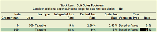

Setting slab-wise GST details (tax on item rate)
1. Go to Gateway of Tally > Inventory Info. > Stock Items > Alter > select the item.
2. S et/alter GST Details - Yes .
3. Calculation type - On Item Rate .
The Tax on Item Rates screen appears.
o Consider additional expense/income ledger for slab rate calculation - Set this option to Yes when you want to apportion additional expenses in slab rate calculation for a stock item.
o Under Rate , set the slab rates in Greater than and Up to .
o Set the Tax Type and Integrated Tax Rate . The Central Tax Rate and State Tax Rate will get automatically calculated.
4. Press Ctrl+A to accept the GST Details screen.
5. Save the details in the Stock Item Alteration screen.
