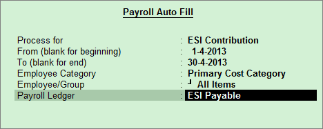

1. Go to Gateway of Tally > Payroll Vouchers > Ctrl + F4: Payroll .
2. Press F2 to change the Voucher Date .
3. Click A : Payroll Auto Fill .
4. Select the required process in Process for field.
5. Enter the From and To date.
6. Select the appropriate Employee Category.
7. Select the Employee/Group from the List of Employees/Group .
8. Select the appropriate Payroll Ledger from the List of Ledger Accounts .

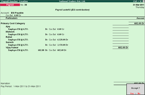

9. Press Enter to go to Payroll Voucher Creation screen.
10. Press Enter to save.

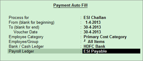

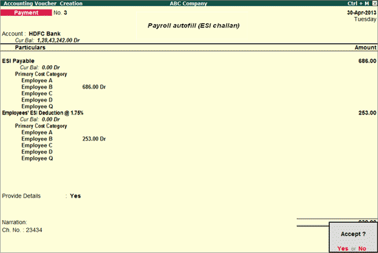

ESI Payment
2. Press F2 to Change the Voucher Date .
3. Press A : Payroll Auto Fill .
4. Select the ESI Challan in Process for field
5. Enter the From and To dates
6. Enter the Voucher Date .
7. Select the appropriate Employee Category .
8. Select the Employee/Group from the List of Employees/Group .
9. Select the appropriate Bank/Cash Ledger from the List of Ledger Accounts .
10. Select the appropriate Payroll Ledger from the List of Ledger Accounts .
11. Press Enter to show the Employee’s ESI Contribution, and select End of List .

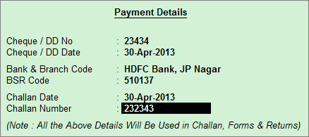

12. Select Yes in Provide Details field, if you wish to print the Payment Details in ESI Challan .
13. In the Payment Details screen enter the C heque/DD No. , Cheque/DD Date , Challan Date , Bank & Branch Code .
14. Press Enter , and fill Narration , if any.
15. Press Enter to save.

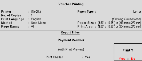

ESI Payment Challan
1. Press No in the Accounting Voucher Creation screen, and press Alt+P .
2. In the Voucher Printing screen, select Yes in the Print Challan field.
3. Press Yes to print the ESI Challan .

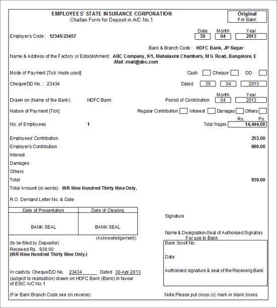

The ESI Challan displays the employees’ ESI share, and employer’s contribution for the selected month along with the other details.
Note: The Number of Employees is printed based on the employee count for whom the ESI Number is entered in the employee master.
