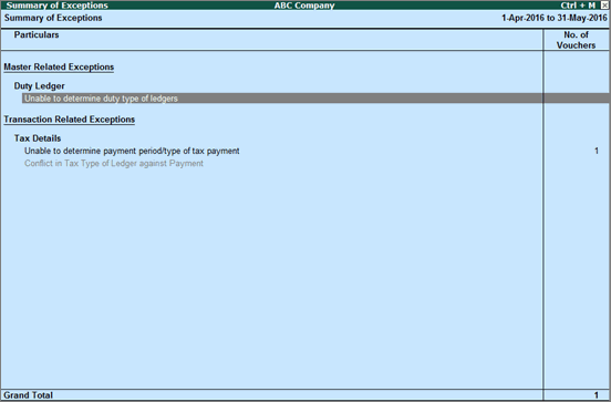

Drill down on this row to view tax payment vouchers with insufficient information. Summary of Exceptions screen displays the count of payment vouchers which are not considered in the VAT return due to insufficient information. The Summary of Exceptions screen appears as shown below:
Master Related Exceptions
Duty Ledger
Unable to determine the duty type of ledgers : Displays payment vouchers in which the Type of duty/tax of tax ledger is set to Others .
In payment voucher recorded using Stat Payment feature, if the tax ledger used is predefined with the tax type, Others ( Type of duty/tax option of tax ledger set to Others ), the voucher appears under this exception.
To solve this exception
1. Select Unable to determine the duty type of ledgers and press Enter .
2. Click S : Set Duty Type .
3. Select the Type of Duty/Tax from the list.
4. Press Ctrl+A to a ccept the Update Duty Type screen.
Transaction Related Exceptions
Tax Details
Unable to determine the payment period/type of tax payment : Displays the count of payment vouchers recorded without using the Stat Payment feature.
Payment voucher recorded with tax ledger predefined with tax types - VAT or CST, appears under this exception when the Stat Payment feature is not used.
1. Select Unable to determine the payment period/type of tax payment and press Enter .
2. Click S : Set Details .
3. Select the Tax Type from the list.
4. Enter the dates in Period From and To fields.
5. Press Ctrl+A to a ccept the Stat Payment Details screen.
Conflict in Tax Type of Ledger against Payment : Displays the count of payment vouchers in which ledgers predefined with other tax types like CENVAT and service tax are used.
In payment voucher recorded by selecting VAT or CST as the Tax Type in Stat Payment Details screen, if the tax ledger used is predefined with tax types - CENVAT, Service Tax, TDS or TCS, the voucher appears under this exception.
1. Select Conflict in Tax Type of Ledger against Payment and press Enter .
2. Select the transaction and press Enter .
3. Replace the incorrectly selected tax ledger with VAT or CST ledger.
4. Press Ctrl+A to accept the voucher.

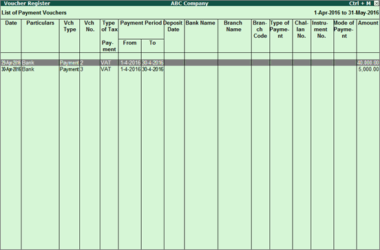

VAT Paid
Displays the amount of VAT paid in the financial year. Drill down from this row to view the list of payment vouchers recorded by VAT remittance. The list of payment vouchers appears as shown:
You can enter bank details and challan no. of payment by clicking V : Alter Details .
