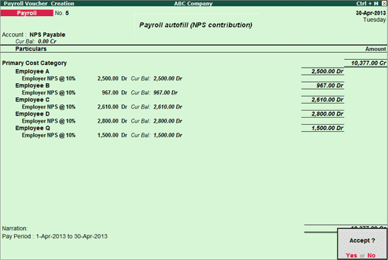

Processing Employer's NPS Contribution with the Calculation Type - As Computed Value
1. Go to Gateway of Tally > Payroll Vouchers > Ctrl + F4: Payroll.
2. Press F2 to change the Voucher Date.
3. Click A : Payroll Auto Fill or press Alt+A.
4. Select the NPS Contribution in Process for field.
5. Enter the From and To date.
6. Select the appropriate Employee Category.
7. Select the Employee/Group from the List of Employees / Group.
8. Select the appropriate Payroll Ledger from the List of Ledger Accounts.
9. Press Enter to go to Payroll Voucher Creation screen
10. Accept to save.

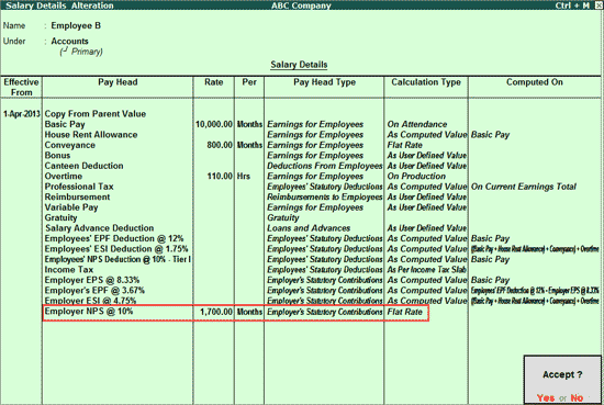

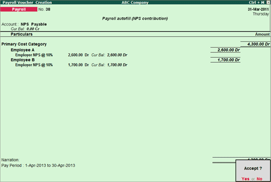

Processing Employer's NPS Contribution with the Calculation Type - Flat Rate
9. Press Enter to go to Payroll Voucher Creation screen.
Note: Prior to recording a Payroll voucher for NPS Contribution with the Calculation Type - Flat Rate , ensure that the contribution amount is specified in the Salary Details of an employee as shown:
