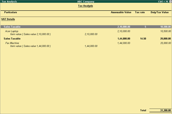

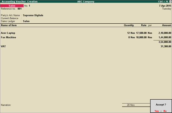

To record local sales transactions for items attracting multiple VAT rates
2. Enter the reference number in Reference no. field.
4. Select a common sales ledger in which the option Is VAT/CST Applicable? is set to Applicable , and the option Set/Alter VAT Details? is not enabled.
5. Select the required stock items whose VAT rates are specified either at the stock group level, or at the stock item level. Enter Quantity and Rate for each stock item.
6. Select the common VAT ledger.
● The ledger must be grouped under Duties & Taxes in which the options:
o Type of duty/tax is set to VAT .
o Percentage of Calculation is set to 0.
7. Click A : Tax Analysis to view the Tax Analysis screen.
o Click F1 : Detailed to view in detailed mode. The Tax Analysis screen appears as shown below:
o Press Esc to return to sales invoice.
8. Press Enter to save.

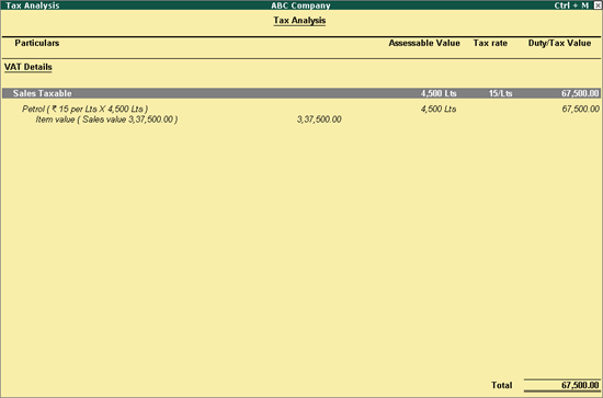

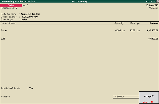

Taxable Sales - VAT Calculation Based on Quantity
Jharkhand VAT
To record sale of stock item predefined with VAT amount per unit
2. Enter Reference no .
3. Select the party ledger in Party's A/c Name option.
4. Select a common sales ledger in which the option Is VAT/CST Applicable? is set to Applicable , and the option Set/Alter VAT Details? is set to No .

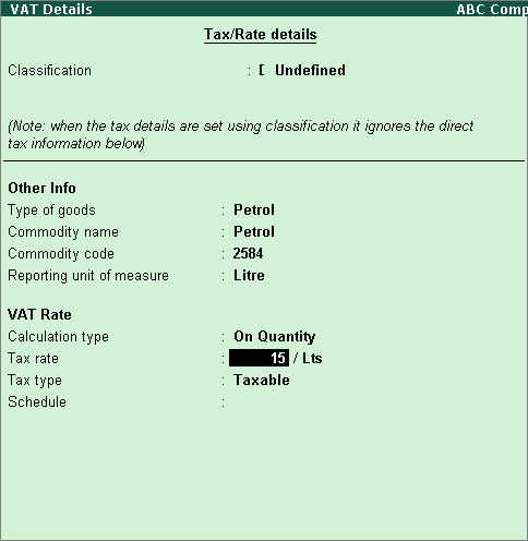

5. Select the required stock item whose VAT rate per unit is specified in the stock item.
6. Define the VAT rate per unit for the stock item as shown below:
Note: To select the calculation type in stock item, ensure the option Enable VAT calculation on quantity? is set to Yes in the Company VAT Details screen.
7. Enter the Quantity and Rate for the stock item.
8. Select the common VAT ledger.
9. Click A : Tax Analysis to view the Tax Analysis screen.
o Click F1 : Detailed to view the stock items. The Tax Analysis screen appears as shown below:
Note: The tax for each item is calculated based on the rate specified in the stock item master by selecting On Quantity in the Calculation Type .
10. Set the option Provide VAT Details? to Yes and enter the details in the Statutory Details screen.
11. Press Enter to save.

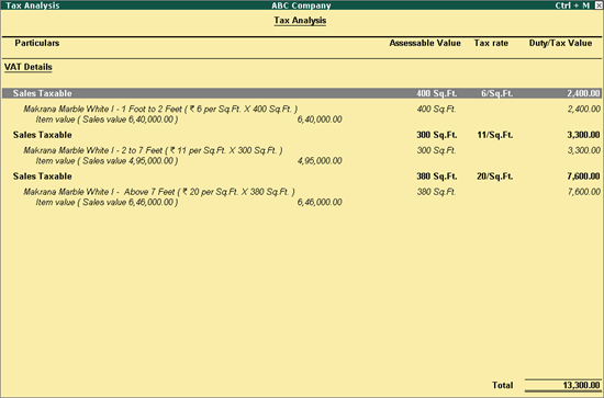

Rajasthan VAT
To record transaction of local sales for items attracting multiple VAT rates
2. Enter Ref. number, if required .
3. Select the party ledger in Party's A/c Name field.
4. Select a common sales ledger in which the option Is VAT/CST Applicable? is set to Applicable , and Set/Alter VAT Details? is disabled.
7. Set the option Provide VAT Details? to Yes to view the Statutory Details screen.
8. Click A : Tax Analysis to view the Tax Analysis screen.
Note: The tax for each item is calculated based on rate specified in the stock item master by selecting On Quantity in the Calculation Type .
9. Press Enter to save.

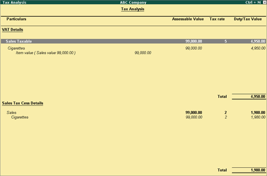

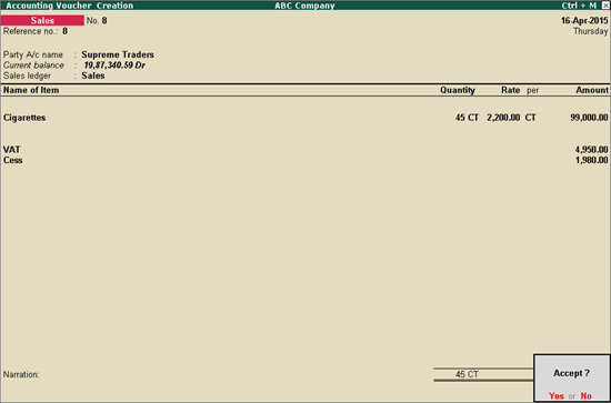

Taxable Sales with Cess for Uttarakhand VAT
To record sales with VAT and cess
5. Select the required stock item whose VAT rate is specified either at the stock group or stock item level.
6. Enter the Quantity and Rate for the stock item.
7. Select the common VAT ledger.
o Percentage of Calculation (eg 5)? is set to 0.
8. Select the cess ledger .
10. Enter Narration , if required.
Note: Cess is not calculated in the following scenarios:
♦ Other tax/duty ledgers and additional ledgers selected for expense/income enabled for apportionment to the assessable value are not considered for cess calculation.
♦ Invoice configured with voucher class to display the stock item value inclusive of tax does not consider cess value.
♦ MRP of stock items is not considered for cess calculation.

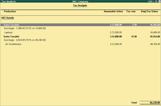

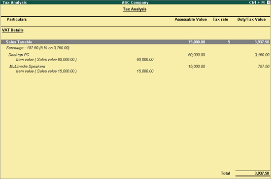

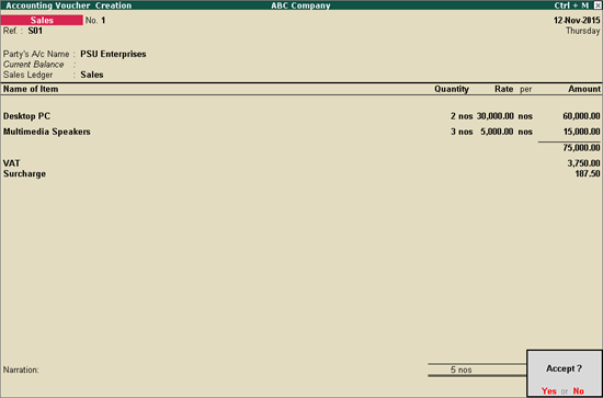

Sales with Surcharge
Haryana VAT
2. Enter Ref number, if required .
4. Select a common sales ledger in which the option Is VAT/CST Applicable is set to Applicable , and Set/Alter VAT Details is disabled.
5. Select the required stock items whose VAT rates are specified either at the stock group or stock item level. Enter Quantity and Rate for each stock item.
7. Select the surcharge ledger.
8. Click A : Tax Analysis to display the Tax Analysis screen.
o Click F1 : Detailed button to view the names of stock items.
Press Esc to return to tax invoice.
The tax invoice appears as shown below:

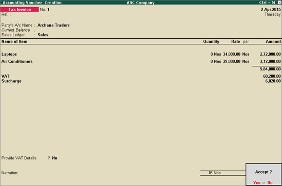

Punjab VAT
1. Go to Gateway of Tally > Accounting Vouchers > F8: Sales > Tax Invoice .
4. Select a common Sales Ledger in which the option Is VAT/CST Applicable? is set to Applicable , and Set/Alter VAT Details? is set to No .
7. Select the common surcharge ledger.
9. Click F1 : Detailed to view the names of stock items. The Tax Analysis screen appears as shown below:
10. Press Esc to return to tax invoice.
11. Set the option Provide VAT Details? to Yes to view the Statutory Details screen.
● Enter the G.R. No. , and dt , Name of Transporter , and Serial No. of Form VAT-36 .
● Press Enter to return to tax invoice.
12. Press Enter to save.

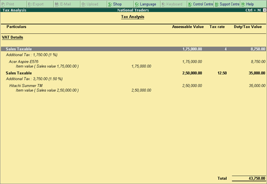

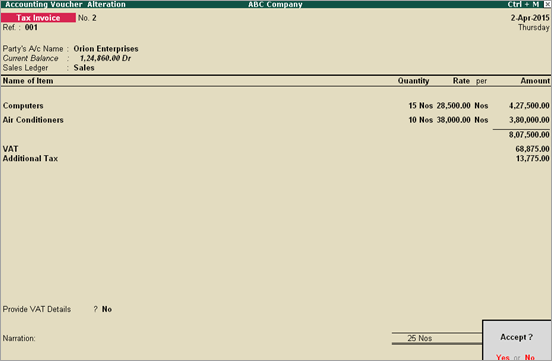

Sales with Additional Tax
Gujarat VAT
4. Select a common sales ledger in which the option Is VAT/CST Applicable is set to Applicable , and Set/Alter VAT Details is set to No .
7. Select the common additional tax ledger.
9. Press Esc to return to sales invoice.
10. Set the option Provide VAT Details? to Yes to view the Statutory Details screen.
● Set the option Type of invoice to Tax Invoice .
● Enter the other details.
● Press Ctrl+A to accept.

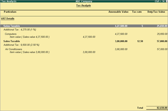

Uttar Pradesh
To record local sales of items with multiple VAT rates
8. Click A : Tax Analysis button to display the Tax Analysis screen.
9. Click F1 : Detailed button to view the names of stock items. The Tax Analysis screen appears as shown below:
