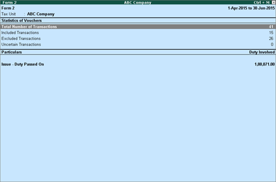

Generate Form 2 report
1. Go to Gateway of Tally > Display > Statutory Reports > Excise Reports > Dealer > Form - 2 .
2. Select the Excise Tax Unit .
3. Press Enter to generate Form 2 report . The Form 2 report appears as shown below:
Statistics of Vouchers
All the voucher types used for recording transactions in a particular quarter are displayed here. The total number of transactions recorded using each of these voucher types is captured in the adjacent column. Drill-down reports of each voucher type leads to Voucher Monthly Register , followed by Voucher Register and the voucher alteration screen. The total voucher count displayed in Statistics report will be same as the count shown in the Total Number of Transactions row of Form 2 report.
Note: This report is similar to the Statistics report of Statement of Accounts menu.
Statistics displays the count of vouchers recorded in a particular quarter. This section provides information on the:
● Total Number of Transactions : It displays the count of all the transactions recorded in the selected quarter. The total count is categorised as Included Transactions , Excluded Transactions and Uncertain Transactions . Voucher count appears against each of these categories. The drill-down report of this row displays the Statistics report comprising voucher types with the corresponding voucher count.
● Included Transactions : Displays all the vouchers which will form part of Form 2 . Displays the count of:
o Excise sales and excise purchase returns linked to excise purchases.
o Excise purchases and excise sales returns linked to excise sales.
The count of only those transactions which are linked to the selected excise tax unit appears here. If any transaction fulfils all requirements of Form 2 but belongs to another excise tax unit, the count of such transaction is displayed in Excluded Transactions row.
● Excluded Transactions : Displays all vouchers which do not form part of Form 2 . As excise details are not provided in these transactions, there will be no implications on the return. It displays the count of all the:
o Transactions which belong to other excise tax units.
o Transactions of excise purchase and excise credit note which are pending to be cleared/sold in the selected quarter.
o Transactions of stock transfer recorded using inventory vouchers.
o Transactions which do not attract excise.
o Payroll vouchers.
o Inventory vouchers.
o Transactions which are manually excluded by user.
● Uncertain Transactions : It displays the complete list of information gaps found in transactions. Until these details are specified, either in masters or transactions, the transaction will not be considered for filing returns. It consists of two broad categories, Master Related Exceptions and Transactions Related Exceptions . All the transactions which are displayed here requires user intervention to provide the appropriate details. Provision to completely exclude uncertain transactions is also made available. Hence, entries which have information gaps and are not required to be shown in Form 2 report, can be moved to Excluded Transactions section .

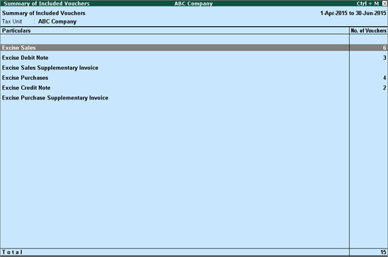

Summary of Included Vouchers
This report displays the logical grouping of voucher types used for recording excise transactions which are captured in Form 2 . The total voucher count displayed in Summary of Included Vouchers report will be same as the count shown in the Included Transactions row of Form 2 report.
The Summary of Included Vouchers report appears as shown below:
Excise Sales
The count of excise sales transactions are displayed here if they are recorded by linking it to the:
● Excise tax unit selected for generating Form 2 .
● Relevant excise receipts (purchases and credit note).
If multiple voucher types are created and used for recording sale of excisable goods by selecting the tax unit, the total count of all such transactions are displayed as Excise Sales .
Excise Debit Note
The count of excise debit note transactions recorded by linking it to the:
● Relevant excise purchases.
If multiple voucher types created and grouped under debit note voucher type are used for recording purchase returns of excisable goods, the total count of all such transactions are displayed as Excise Debit Note .
Excise Purchases
The count of excise purchases recorded by:
● Linking it to the excise tax unit selected for generating Form 2 .
● Selecting the Nature of Purchase .
● Providing the supplier details.
If multiple voucher types created and grouped under purchase voucher type are used for recording purchase of excisable goods, the total count of all such transactions will be displayed as Excise Purchases .
Excise Credit Note
The count of excise credit note recorded by:
If multiple voucher types created and grouped under credit note voucher type are used for recording sales returns of excisable goods, the total count of all such transactions are displayed as Excise Credit Note .
On pressing Enter from any of the aforementioned categories of vouchers, the Included Vouchers report appears, followed by the voucher alteration screen.

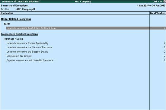

Summary of Exceptions
If transactions recorded in the period selected to generate Form 2 have information gaps, the count of such transactions appears under the relevant sections of this report. This report has two broad categories, Master Related Exceptions and Transactions Related Exceptions .
If a transaction has:
● One exception, the transaction will move to Included Transactions immediately after it is solved.
● Multiple exceptions, the user will be guided through a procedural manner. Exceptions will appear one after the other (and not all of them at a time) intuitively to guide the user in solving all of them completely.
After recording purchase and sales transactions if excise is enabled, such transactions get listed under each exception. Once the excise related details are provided the exceptions will be solved.
The Summary of Exceptions screen appears as shown below:
Master Related Exceptions - Tariff
Unable to determine Tariff details for Stock Item : Transaction count appears under this exception when Tariff name, HSN Code, Reporting UOM, Valuation Type, Type of Duty and Rate of Duty are not defined in the stock item master.
To solve this exception
1. Press Enter on Unable to determine Tariff details for Stock Item . The Tariff Details screen appears with item-wise details.
2. Select the stock item. If same tariff is applicable to multiple items, select them by pressing Spacebar .
3. Click S : Set Tariff Details button.
4. Enter the Tariff name and HSN code .
5. Select the Reporting unit of measure and Valuation type .
6. Set Calculate duty on MRP to Yes only if the duty calculation is based on MRP and enter the Abatement % . If not, retain it as No .
7. Select the Type of Duty as Basic Excise Duty and enter the Rate % or Rate per Unit depending on the Valuation Type .
The exception will be solved.
Transactions Related Exceptions - Purchase/Sales
The exceptions or information gaps found at the transaction level are listed here.
Unable to determine Excise Applicability : Count of transactions appears under this exception when, Tax Unit is not selected in the transactions. If there any transactions of purchase, sale, debit note and credit note recorded before enabling excise, then all such transactions will appear under this exception.
If there are multiple tax units, then the relevant tax unit can be selected in debit and credit notes only if the option Allow selection of Tax Unit for Credit Note/Debit Note is enabled in the Configuration screen of the invoice. If this option is not enabled, the transactions cannot be identified with any excise tax unit. Hence, it appears under this exception.
To view the list of transactions, click V : Show Vouchers button. The transaction displayed here can be:
● Corrected, which will automatically move the transaction under Included Transactions section.
● Moved under Excluded Transactions section by clicking X : Exclude Vouchers button if they are not required to form part of the return. Such transactions will be moved to Excluded by User category of Excluded Transactions .
● Marked as a non-excise voucher.
1. Press Enter on Unable to determine Excise Applicability .
2. Select the transaction. If same excise tax unit is applicable to multiple transactions, select the required transaction by pressing Spacebar .
3. Click E : Excise button.
4. Select the relevant Excise Tax Unit .
5. Press Enter to accept it.
Unable to determine the Nature of Purchase : Transaction count appears under this exception when the Nature of Purchase is set to Not Applicable in the Party Details screen of excise purchase and excise credit note transactions.
To view the list of transactions recorded without selecting the Nature of Purchase , click V : Show Vouchers button. The transaction displayed here can be:
To solve this exception and accept the difference
1. Press Enter on Unable to determine the Nature of Purchase
2. Select the transaction. If party ledgers of multiple transactions have to be allocated to same nature of purchase, select all of them by pressing Spacebar .
3. Click S : Set Nature of Purchase button.
4. Select the required Nature of Purchase .
Unable to determine the Supplier Details : Transaction count appears under this exception when the dealer excise feature is enabled after recording purchase invoice and credit note.
To view the list of transactions recorded without providing supplier details, click V : Show Vouchers button. If the transactions displayed are not required to form part of the return, it can be moved under Excluded Transactions section by clicking X : Exclude Vouchers button.
1. Press Enter on Unable to determine the Supplier Details .
2. Press Enter to view the Accounting Voucher Alteration screen of purchase invoice or credit note.
3. Place the cursor on Amount field and press Enter to display the Excise Details screen.
4. Enter the:
● Relevant details under Supplier Invoice Details, Manufacturer/Importer Details and Duty Details in Excise Details screen of purchase invoice.
● Sales Invoice Number , Sales Invoice Date and select the sales invoice to link it to the credit note.
5. Accept the invoice.
Mismatch in tax amount : Displays the count of transactions in which difference is found between the calculated amount and transaction value. In the Excise Details screen of excise purchase and excise credit note, the Duty Amount appears based on the Rate of Duty . If the Rate per Unit is entered, the Duty Amount gets recalculated based on this. When the recalculated Duty Amount is not matching with the Duty Amount which was originally calculated based on the Rate of Duty , the invoice appears here.
1. Select the exception Mismatch in tax amount .
2. Press Enter .
3. Use any of the following options to solve it:
● Click A : Accept as is button to accept the transaction without making any corrections. The accepted transactions will be moved under Included Transactions .
● Click S : Create Adjustment button to create a journal voucher to account for difference in tax amount.
● Click L : Link Adjustment button to link it to an existing transaction. On clicking this button, the list of transactions which can be linked will be displayed for selection. If any of it can be linked, select it and click S : Save button.
To modify the transaction manually
1. Select the transaction
2. Press Enter to view the Voucher Alteration screen.
3. Place the cursor on Amount field.
4. Press Enter to display the Excise Details screen.
5. Remove the Rate per Unit to auto-calculate the Duty Amount or enter the correct Rate per Unit .
6. Accept the invoice.
The transaction displayed here can be moved under Excluded Transactions section by clicking X : Exclude Vouchers button if they are not required to form part of the return.
Supplier Invoices are Not Linked to Clearance : Transaction count appears under this exception when the purchase invoices are not selected in Supplier Details screen of excise sales invoice and debit note.
1. Press Enter on Supplier Invoices are Not Linked to Clearance
2. Select a transaction and press Enter . The List of Supplier Invoices screen is displayed.
3. Select the corresponding purchase transaction. A sales invoice can be linked to:
● Only one purchase invoice as full clearance.
● Multiple purchase invoices as partial clearance by entering the quantity to be linked for each invoice.
4. Click F4: Full button to consume the entire quantity or click F5: Partial to consume partial quantity from the purchase invoice.
5. Press Enter to save.
