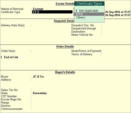

6. In the Party Details screen,
o Select Exempt in Nature of Removal .
o Select CT3 in Certificate Type , and enter the other required details.

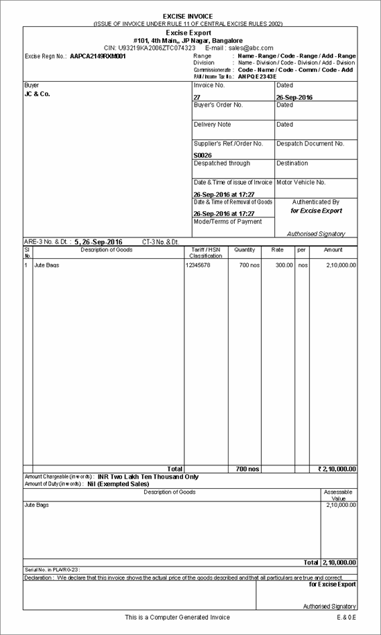

Printing Rule 11 invoice
To print Rule 11 Invoice
● Set Print ARE-3 to No i n the Voucher Printing screen.
The print preview appears as shown below:
Note : The ARE-3 number and CT-3 number and date of issue of the CT-3 will be captured in Rule 11 invoice.

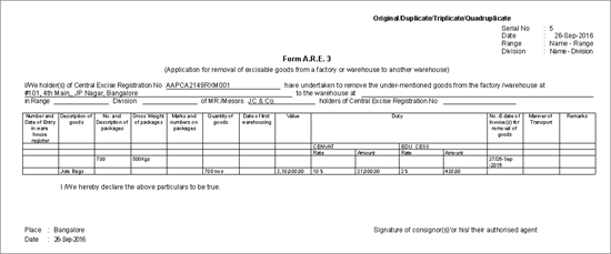

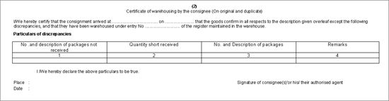

Printing Form A.R.E. 3
From the Voucher Alteration screen, press Alt+P .
To print ARE-3
1. Set Print ARE-3 to Yes .
2. Enter the other required options.
Form A.R.E. 3 appears as shown below:
