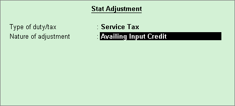

2. Click J : Stat Adjustment .
3. Select Service Tax in the field Type of duty/tax .
4. Select Availing Input Credit in the field Nature of Adjustment .
The Stat Adjustment screen appears as shown below:

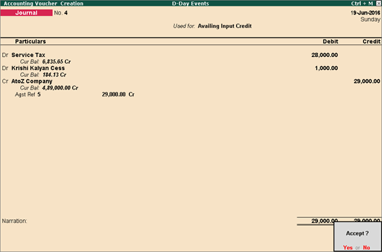

8. Credit AtoZ Company . The amount will be automatically filled.
9. Select the Bill-wise Details , and press Enter to return to voucher. The journal voucher appears as shown below:
10. Press Enter to save.
