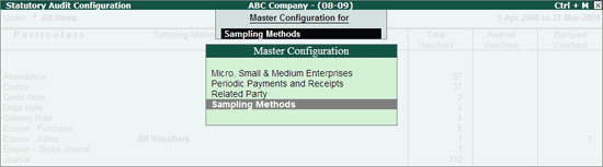

1. Go to Gateway of Tally > Audit & Compliance > Audit & Analysis > Verification of Vouchers .
2. Click Ctrl+F9 : Master Config or press Ctrl+F9 .
3. Select Sampling Methods and press Enter .

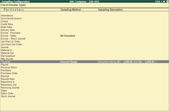

4. Select the required Voucher Type and press Spacebar .
5. Click on S : Sampling or press Alt+S to select the Sampling Method .
Select the required Sampling Method and press Enter .

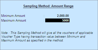

Amount Range : This sampling method should be applied to display all the Vouchers having the Ledger value between Minimum and Maximum Amount as Debit/Credit/Both as specified by the Auditor.
Example : For sampling method specified for Ledger/Group with minimum and maximum amounts as 2000 and 5000 respectively. This sampling method will give vouchers having Ledger values from 2000 to 5000 having Debit or Credit or both.

6. Enter the required amount range in the Minimum Amount and Maximum Amount fields respectively.
7. Press Enter to select the Sampling Method details.
Similarly the required Sampling Methods can also be applied to the other Voucher Types also.

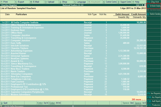

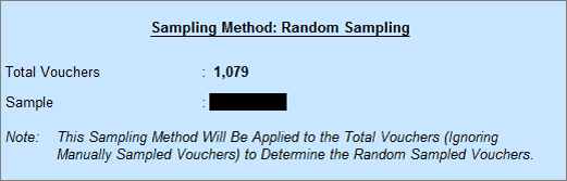

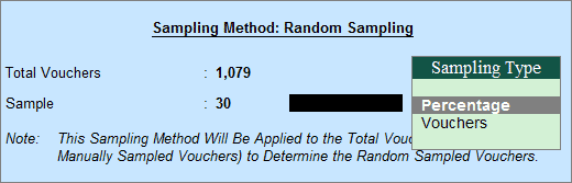

● Ctrl+R: Random Sampling : Random Sampling is a principal method of Audit Sampling and a button to apply the same in Tally.ERP 9 has been provided in the Sampling Configuration screen. Β In the Sampling Configuration screen, click Ctrl+R : Random Sampling or press Ctrl+R . The Sampling Details screen is displayed as shown below:
o Sampling Types : The Vouchers can be sampled as a Percentage, or a number, of the total number of Vouchers.
o Select the Sampling Type and press Enter . A List of Vouchers gathered using Random Sampling method will be displayed for view:
To accept the listed Vouchers for random sampling, press Alt+S or click S : Set Sampling . Tally.ERP 9 will mark these Vouchers as Randomly Sampled.
