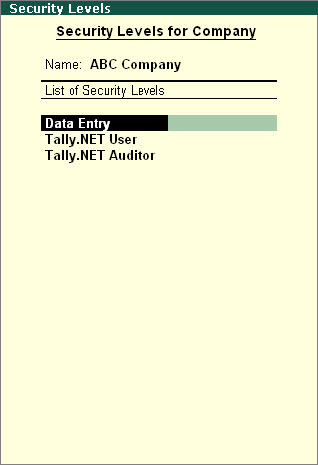

1. Go to Gateway of Tally > F3: Cmp Info. > Security Control > Types of Security .
2. Select the security level (for example Data Entry ), in the Security Levels screen for the company, under List of Security Levels , and press Enter .

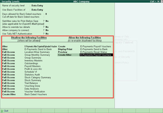

3. Select the Security List type under the Use Basic Facilities of .
4. Select the Type of Access you want to provide for the different reports (Refer to the following image.) under the Disallow the following Facilities and Allow the following Facilities categories, as shown below:
5. Press Enter to go back the main Security Levels screen for the company.
6. Press Enter to accept the security settings for Data Entry level.
