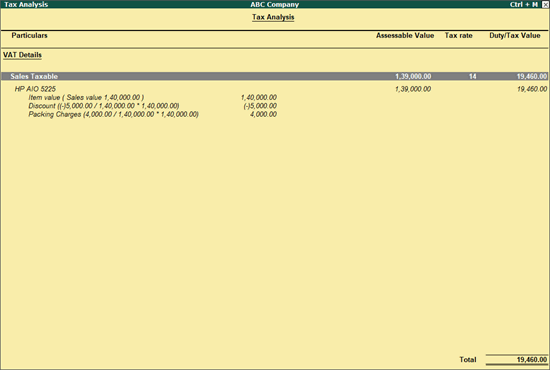

10. Click A : Tax Analysis button to display the Tax Analysis screen.
11. Click F1 : Detailed button to view the names of stock item with assessable value including expense amount. The Tax Analysis screen appears as shown below:
12. Press Esc to return to sales invoice.
