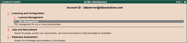

2. Press Ctrl+K to access the Control Centre .
3. Log in to the Control Centre using your e-mail ID and Tally.Net password.
4. Select TDL Management , as shown below:

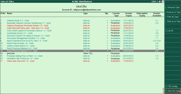

5. Press Enter . The List of TDLs screen appears as shown below:
6. Click F9: New TDL Config in the List of TDLs screen. The TDL Configuration Management screen appears.

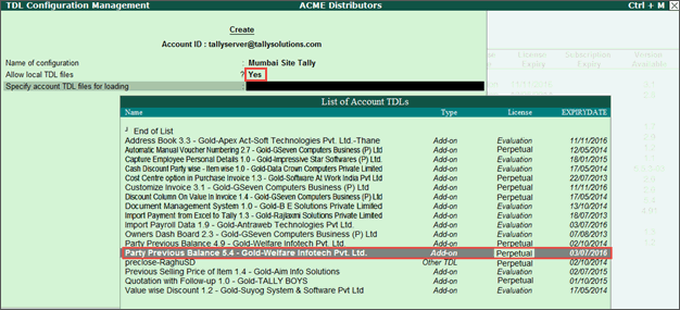

7. Enter a name for the TDL pack in the Name of Configuration field.
8. Set the option Allow local TDL files? to Yes .
9. Select your desired add-ons from the List of Account TDLs in the Specify Account TDL files for loading field.
Note: In the List of Account TDLs , the add-ons purchased by you appear as Perpetual under License . The add-ons that are being used by you on a trial basis appear as Evaluation .
10. Press Ctrl+A to accept.
The specified add-ons are added to the new TDL configuration pack that you created.

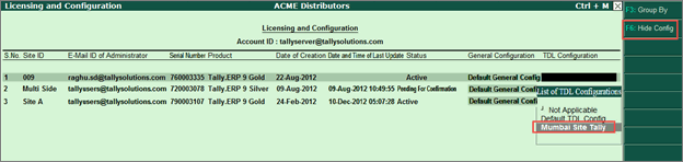

2. Click License Management . The Licensing and Configuration screen appears.
3. Click F6: Show Config .
4. Select the Site ID to which the TDL Configuration pack has to be added.
5. Select the TDL Configuration pack from the List of TDL Configurations , as shown below:
6. Press Ctrl+A to accept.
The TDL configuration pack is now added to the site.
Note: To ensure availability of the TDL, update the license of the site.
You can confirm the availability of the add-ons by going to F12: Configure > Product & Features . The add-ons linked to the site will appear under the TDL Files/Add-ons section in the Product & Features screen.
