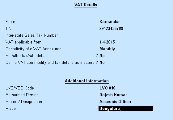

1. Go to Gateway of Tally > F11: Features > Statutory & Taxation .
2. Enable the option Set/alter VAT Details . The Company VAT Details screen appears as shown below:
3. Select the State .
Note:
♦ State is auto filled if you have selected the state during company creation.
♦ The name of new union territory Dadra & Nagar Haveli and Daman & Diu is provided in Release 6.6.3 . All masters with Daman & Diu and Dadra & Nagar Haveli are automatically updated with the name of new union territory.
4. Enter the TIN .
5. Press Enter to skip Inter-state Sales Tax Number .
6. Enable Set/alter tax/rate details . The Tax/Rate Details screen appears as shown below:
7. Enter the Tax rate , as required.
8. Click F12: Configure to open the Configuration screen to enable CST .
9. Press Enter to return to the Company VAT Details screen.
10. Click F12: Configure to enter additional details if required.
11. Press Ctrl+A to save.

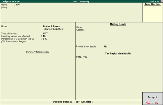

Creating a Tax Ledger
2. Enter the Name of the VAT ledger.
3. Select Duties & Taxes in the Under field.
4. Select VAT as the Type of duty/tax .
5. Set Use for Purchase Tax to No .
6. Press Enter to skip Percentage of Calculation (eg 5) . The Ledger Creation screen appears as shown below:
7. Press Enter to save.
Similarly, create a CST ledger under Duties & Taxes , by selecting CST as the Type of Duty/Tax .
