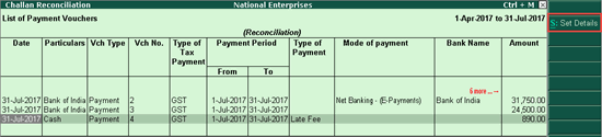

All the tax payment vouchers recorded for paying GST and other liabilities are displayed in Challan Reconciliation report. For each payment, the bank and challan details can be provided from this report.
To view the Challan Reconciliation report
● Go to Gateway of Tally > Display > Statutory Reports > GST > Challan Reconciliation .

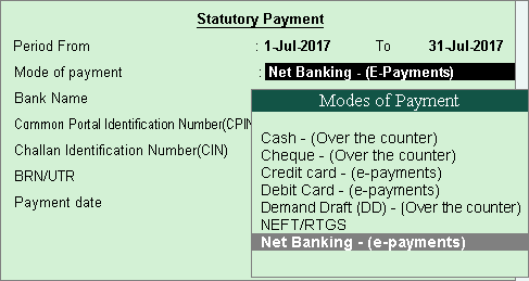

To set the payment details for each transaction
1. Click S : Set Details .
2. Specify the From and To dates.
3. Select the Mode of payment .
4. Enter the details and press Ctrl+A to accept.
The description of each column of Challan Reconciliation report is given below:
Column Names
Description
Date
Displays the payment voucher date.
Particulars
Displays the bank or cash ledger selected in payment voucher.
Vch Type
Displays the name of the voucher type as Payment .
Vch No.
Displays the payment voucher number.
Type of Tax Payment
Displays GST (which is selected as the Tax Type in the Stat Payment Details screen of payment voucher).
Payment Period
Displays the From and To dates entered in Stat Payment Details screen of Challan Reconciliation report.
Type of Payment
Displays the payment type based as Interest , Late Fee, Others or Penalty , selected for the first ledger in the payment voucher.
Mode of payment
Displays the Mode of payment selected in the payment voucher or in the Challan Reconciliation report.
Bank Name
Displays the Bank Name entered in the payment voucher or in the Challan Reconciliation report.
Common Portal Identification Number (CPIN)
Displays the Common Portal Identification Number (CPIN) entered in the payment voucher or in the Challan Reconciliation report.
Challan Identification Number (CIN)
Displays the Challan Identification Number (CIN) entered in the payment voucher or in the Challan Reconciliation report.
BRN/UTR
Displays the BRN/UTR entered in the payment voucher or in the Challan Reconciliation report.
Instrument Number
Displays the Instrument number (if the mode of payment is selected as cheque or demand draft) entered in the payment voucher or in the Challan Reconciliation report.
Instrument Date
Displays the Instrument date (if the mode of payment is selected as cheque or demand draft) entered in the payment voucher or in the Challan Reconciliation report.
Payment Date
Displays the Payment date entered in the payment voucher or in the Challan Reconciliation report.
Amount
Displays the amount entered in the payment voucher.
