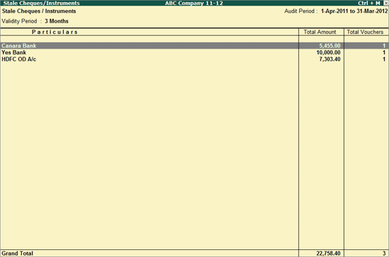

The Stale Cheques/Instruments report provides the details of Bank-wise Total Amount and Count of Stale Cheques/Instruments. To filter the transactions in this report, by default 3 months has been set as Validity Period for Cheques/Instruments. The Stale Cheques/Instruments report displays the instruments for which the Β Validity Period has been exceeded, by comparing Bank Date with Instrument Date of the transactions.

View Stale Cheques/Instruments
Go to Gateway of Tally > Audit & Compliance > Audit & Analysis > Other Analysis > Stale Cheques/Instruments .

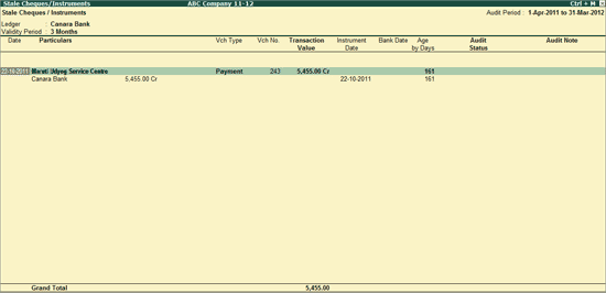

Auditor can drill down from the above report to view Stale Cheques/Instruments Transactions. Select a Bank and press Enter .
The above report displays the details of the Stale Cheque/Instrument transactions along with Voucher Type, Voucher Number, Transaction Value, Instrument Date, Bank Date, Age by Days, Audit Status and Audit Note.

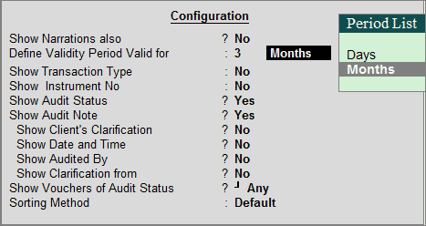

Define Validity Period
In Stale Cheques/Instruments report a facility has been provided to change the Validity Period. To change the validity period click on F6 : Validity Period or press F6 . The Validity Period screen is displayed as shown below:
You can define Validity Period as Months or Days. When the period selected is Months, validity is restricted to 12 and 365 for Days.

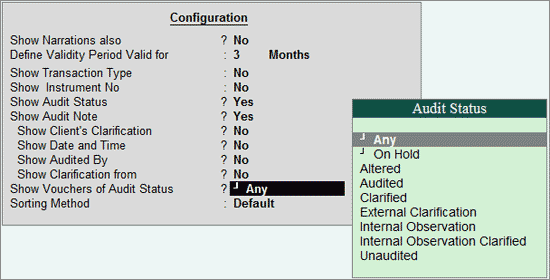

Configuration Options
Click F12 : Configure or press F12 to change the default view for the above report.
● Show Narrations also : Set this option to Yes to display the Narration entered by the Client during the Voucher entry
● Define Validity Period Valid for : In this field alter the valid for period for the bank selected, by defining the validity period as months or days
● Show Transaction Type : Set this option to Yes to display the Transaction Type - Inter Bank Transfer, Cheque deposit etc selected during voucher entry.
● Show Instrument No : Set this option to Yes to display the Instrument Number entered during Voucher entry/reconciliation
● Show Audit Status : Set this option to Yes to display the Audit Status as selected by the Auditor during the Audit. This option is set to Yes by default.
● Show Audit Note : Set this option to Yes to display the Audit Note as entered by the Auditor during the Audit. This option is set to Yes by default.
● Show Client's Clarification : Set this option to Yes to display the Clarification Note entered by the Client for the Vouchers marked as Need Clarification by the Auditor.
● Show Date and Time : Set this option to Yes to view the date on which, and time at which, clarification was provided for the listed Vouchers.
● Show Audited By : Set this option to Yes to view the person who has performed auditing on the Vouchers.
● Show Clarification from : Set this option to Yes to view the user who has provided clarification, if any, for the Vouchers.
● Show Vouchers of Audit Status : Select an Audit Status and the Vouchers that have been marked with the chosen Audit Status will be filtered and displayed.
● Sorting Method : Select the required sorting method: Alphabetical, Amount-wise or No of Days Delayed, for the transactions from the list of Sorting Methods.
