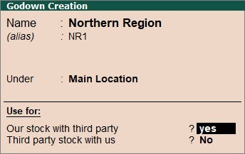

Set up Godowns/Locations to track stock sent to third party
1. Create a godown.
2. In the Godown Creation screen, set Our stock with third party to Yes .
What you see on the screen can vary based on your choices. Press F12 (Configure) to change the options.
3. Accept the screen. As always, you can press Ctrl + A to save.
You can now start using this godown to allocate items sent to third party and record stock transfers to this godown.
