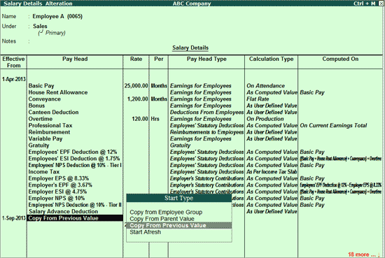

Create or alter salary details

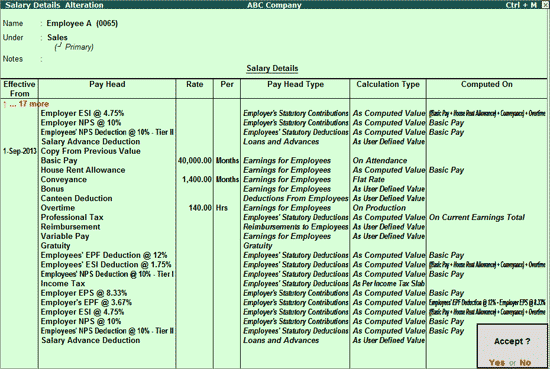

To specify the revised salary details for Employee A, whose Basic Salary has increased by Rs. 15,000,
1. Go to Gateway of Tally > Payroll Info. > Salary Define > Create> Select Employee A from the List of Groups/Employees.
2. Enter 1-9-2013 as the Effective From date.
3. Select Copy From Previous Value from the Start Type.
4. Make the necessary changes to the Pay heads in the Rate Column.
5. Accept to save the changes made.
Note: If a company decides to revise salaries with effect from 1-4-2013, the Pay Heads are required to be altered from the Salary Details screen for the period effective date 1-4-2013 thus overriding the previous effect.

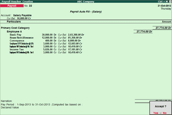

Process Payroll Voucher for Arrears calculation
Create a Payroll Voucher for Employee A for the period 1-10-2013 to 31-10-2013 .
1. Go to Gateway of Tally > Payroll Vouchers.
2. Press Alt+A for Payroll Auto Fill or click A: Payroll Auto Fill .
3. Select the Salary in Process for field.
4. Enter the From and To date in the Employee Filter screen.
5. Select the appropriate Cost Category.
6. Select the Employee/Group (select Employee A alone) from the List of Employees/Group.
7. Select the appropriate Payroll Ledger from the List of Ledger Accounts.
8. Enter the User Defined Pay Head Values e.g. Variable Pay and Salary Advance Deduction.
9. Accept to save the Payroll Voucher.
