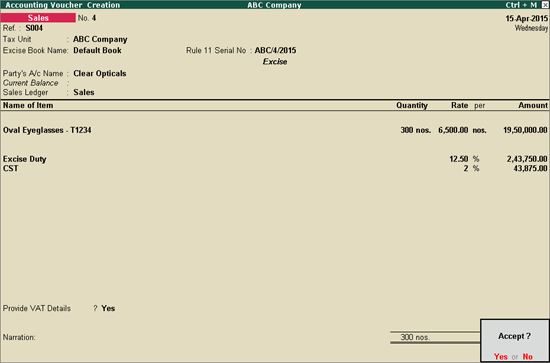

To record an excise sales transaction
2. Enter the reference number in Ref. field.
3. Select the Tax Unit . The Excise Book Name and the Rule 11 Serial No are displayed automatically.
4. Select the party ledger in Party's A/c Name option.
5. Set the option Is Against C Form? to Yes in Party Details screen. This option appears only when the state selected is other than Karnataka.
6. Select a common sales ledger in which the options Is VAT/CST Applicable? is set to Applicable , and Set/Alter VAT Details? is set to No .
7. Select the required stock item.
Note: If the option Is Against C Form? is set to Yes in Party Details screen, the tax gets calculated at 2% CST rate, irrespective of the tax rates defined in the inventory or accounting masters.
8. Select the excise duty ledger.
The ledger must be grouped under Duties & Taxes in which the options:
β Type of duty/tax is set to CENVAT .
β Duty Head set to Basic Excise Duty .
β Percentage of Calculation (eg 5) set to 12.5%.
9. Select the common CST ledger.
β Type of duty/tax is set to CST .
β Percentage of Calculation (eg 5)? is set to 0.
10. Set the option Provide VAT Details? to Yes to view the Statutory Details screen.
In the Statutory Details screen,
o Enter the C Form details. The Statutory Details screen appears as shown below:
o Enter the e-Sugam Details .
o Press Enter to save, and Β return to sales invoice.
11. Press Enter to save.
